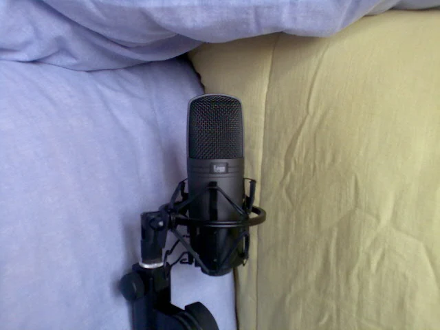

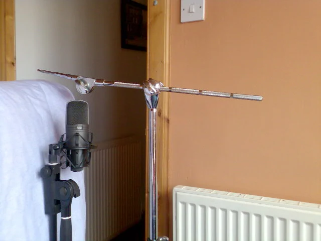

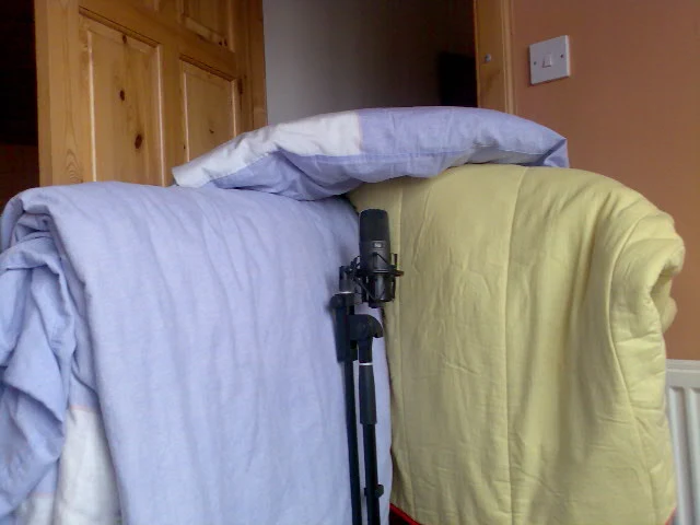

This will certainly suck out all the highs, leaving the lows to boom. I'd suggest if you're gonna use blankets etc, place them round the mic, and as thick as possible(fold into at least quarters). Don't put them all over the walls. Place like so... I used cymbal stands, but you'd be better using mic stands etc.

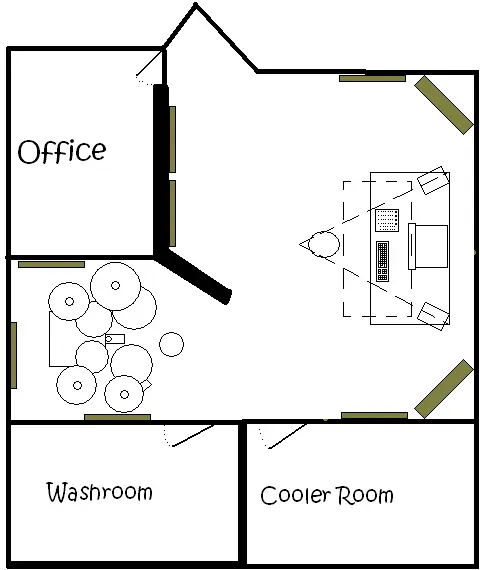

Heres a quick diagram, the live room is a little bit longer (heightwise when looking at the picture from the top) than its shown. The drums arent in the corner, but pretty close.
Im thinking put Roxul in corners behind the comp (where the drums are and where the wall spikes out funnily) and then a make-shift booth with blankets in the "live room", or in the washroom or cooler. Sound good?
Mike
This is what I'd suggest. And have some gobos around the mic in the cooler/wash room.

Pandamonk, that setup makes sense, I see what I can do as far as shifting things around etc.
