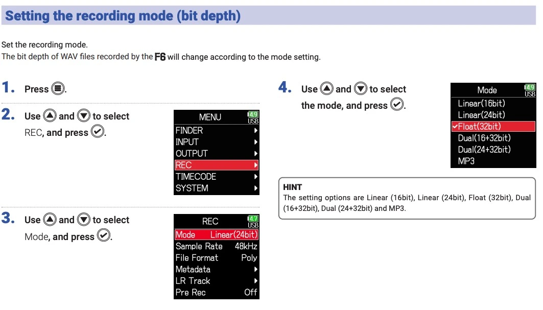

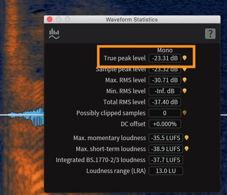

I’m still a bit concerned about the gain "structure" you have set up. The sample recording is *very* low. You should shoot for a [true] peak of say -10dB, and you do that by adjusting the Trim (aka "gain"). That setting is something in the INPUT settings (referenced in my previous post), and is a linear number, that can be from +12 to +75dB. It is not controlled by the "fader" which simply changes what the output level is in the mix/headphones, likely with an audio-taper pot, (and the headphone amp on the Zoom field recorder is likely still one of their weak points). Then, make sure you are recording in at least 24-bit, though since you have the F6, I would certainly use 32-bit [float] mode. If you can't import that directly into your DAW, choose the Dual mode that includes both those settings. See some of the attachments.
p.s. you do want the HPF on for voice work, IMO.

Keith I had seen in YouTube videos to set the trim at +22 maximum, cant remember why at this time. Yes it is set at 24/32bit. When in 32bit the Trim cannot be altered.
In this or these videos the mic has to be invisible which was my reason for using the NGT2.
I thought the Trim was automatically set when it is in 32-bit float mode, and sounds like it is. If you are using the 24-bit file, you need to set it [Trim level] to whatever makes the track record at to give a good signal (vs. noise floor). There's no "fixed" amount that can be given in advance for any mic - it depends on the source being recorded and placement.

Yes originally I just had it set in 32bit which means the input gain is pre set. Yes I watched his vids and what Rob Aylestone said, I repositioned the mic closer.
