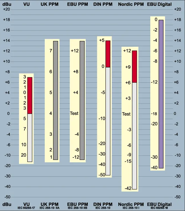

Here, hope this helps:
Hey Flat,
Can I ask where you got that chart from?
G.

SouthSIDE Glen said:
Hey Flat,
G.
I had it in my "illustrations" folder where I save stuff from my web research.
I think it's from something I read awhile ago over at the EM or SOS archive. Do you want me to see If I can find the link to the article??
:D
:D :D
:D :D :D
Well, you don't have to break a sweat finding it for me, I thought maybe you might have the reference at hand. But I would be interested in the article which accompanied it and related information; the graph raises a couple of questions in my mind and I'd like to find out more about it.
G.

masteringhouse said:
It all depends on how you calibrate your system. Some calibrate -18 dBFS to match 0 dbVU others may use -20, -14, or other level.
This is why I wanted to look more into how that chart was created, as it seems to assume not only that the relation between dBu, VU, and dBFS is static, but it also assumes VU is calibrated to +4dBu, and that 0VU is calibrated to ~-14dBFS.
I can live with using the +4 convention for the chart, as long as that's explained as not applying to -10 calibrated gear or to tape machines with VU calibrated to tape saturations instead of line levels. And the -14dBFS calibration, while within the nominal range, does not jive with the conventional wisdom for most gear - at least as has been reported many times in this forum - of -18dBFS. This chart relates -18dBFS to 0dBu instead of 0VU, and doesn't take into account either the reportedly more common standard or the fact that it can reportedly vary by manufacturer.
I gotta run for now, have not yet had time to read the article (THANKS for the link, sunny! :) ), but these are the questions/ambiguities that the chart alone bring to the surface for me at this point.
G.

Thanx for that chart...and thanx for the link Sunnydyz.
I,ve been using -14dbfs for a few years now ever since I started using the PSP "vintage meter " while tracking ( there out of poland I believe). It installs with a default value of 0 VU reference value of -14dbfs. That might be a european idea as to where we should be here across the pond. SOS is out of the U.K. (love the large format and most content, hate the shipping cost)
I think I've seen that 0VU ref. value recomended other places as well, But I guess it's only a de jour standard.
I changed the " vintage meter" VU integration ( attack ballistics) from the default 300 ms to 450 ms and have been very happy with the ease of use from the "old fashioned" :p VU metering.
