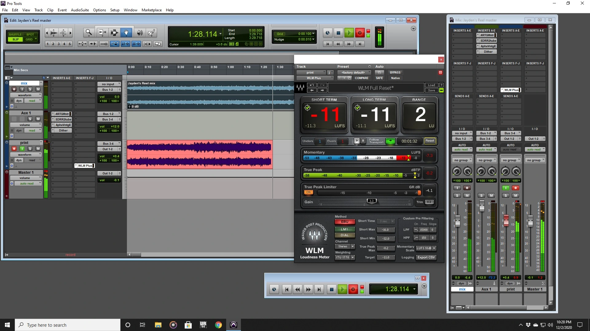

I haven't been mastering very long, and I kind of borrowed this mixer setup in Pro Tools from a youtube video. But I may have some things out of order, IDK.
My main question involves the dynamic range which I can't get above 2 for long term. I have no compressors or limiter on the master, nor on the mix bus inside the mix itself. I only use light compression on individual tracks in the mix. Acoustic music is supposed to be the most dynamic of many genres, so why can't I get the dynamic range higher? I've taken out all the things that would restrict the dynamic range, except a hair of saturation to tame the high frequencies.
Although, it sounds ok to my ears, and maybe I shouldn't be worrying about it all.
In my mastering chain I have the AbbeyRoad Mastering plugin (inside the Abbey Road plugin is a compressor/limiter I am not using), some saturation, an aural exciter and dither.
So this is a print screen of me recording the master showing the loudness meter set at 11 LUFS.
Also the audio file of the song, Jayden's Reel.
View attachment Jayden's Reel master_print-St.mp3

The screenshot of the WLM plug shows the true peak limiter is on and registering -4.1 dB gain reduction. The Master 1 meter shows clipping. I'm curious about the -11 LUFS target. If the track were sent to various streaming services they might want to process it further to reduce the LUFS to -14 or lower. If you were to turn the mix down 3 dB the dynamic range might increase and you wouldn't be hitting the limiter as hard.
One of the problems you might get with increased dynamic range is if you're listening in a noisy enviornment like a car or something, low level stuff could get masked out by background noise. A gentle and transparent compressor on the mix buss might help, which can also save the peak limiter a bit of work. The peak limiter is handy as a safety net if you're not trying to "loudenate" the master. Also, there might be some streaming services that will slap their own peak limiter on if there are true peaks exceeding -1.
Listening to the track, there are a lot of instruments playing together adding density. Nothing wrong with that if it's what you want, but that can also contribute to the low range number. You can still hear transients and such from individual instruments.

That 2 is not really “dynamic range” so much as the “range of dynamics”, which they don’t explain well in the manual, but it’s something like the range of values that the short term loudness covers. Like the difference between the lowest short term loudness and the highest over the course of the program. A band like Nirvana or the Pixies - known for that “quiet verse/loud chorus” thing would probably have large values here. Other bands who pretty much just play full out the whole time will probably have smaller values, and that’s fine if that’s what you’re shooting for. Ultimately, the way to change that value by much is going to be in the arrangement.
