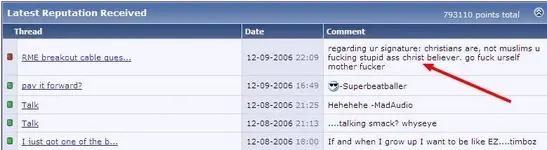

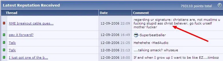

To the pussy that is too chicken-shit to come forward: I am not a Christian, you imbecile. :mad:
I did as you suggested though, but I would have ended up fucking myself without your recommendation.
You should ask Santa for a pair of testicles. Bitch.
