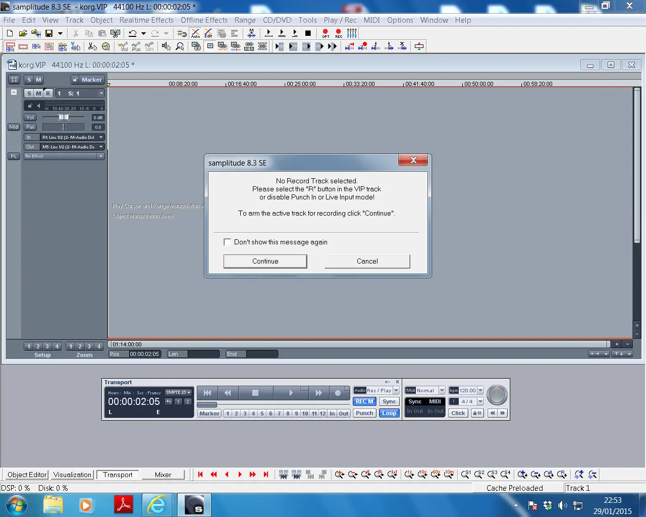

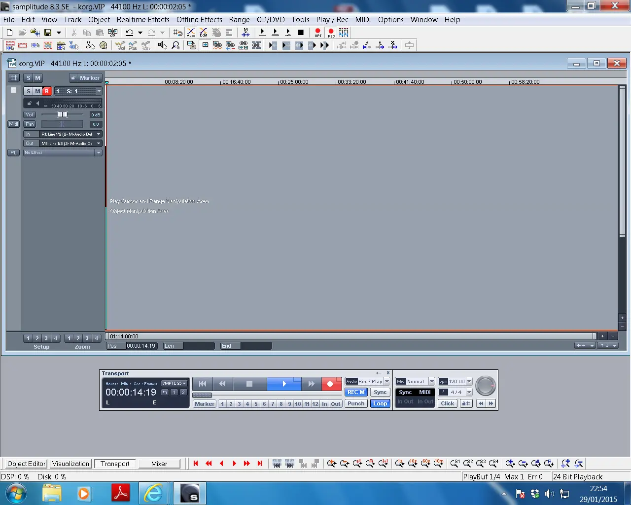

The "Arm" issue is that in most DAWs you need to have at least one track set ready or armed for record or it won't run.

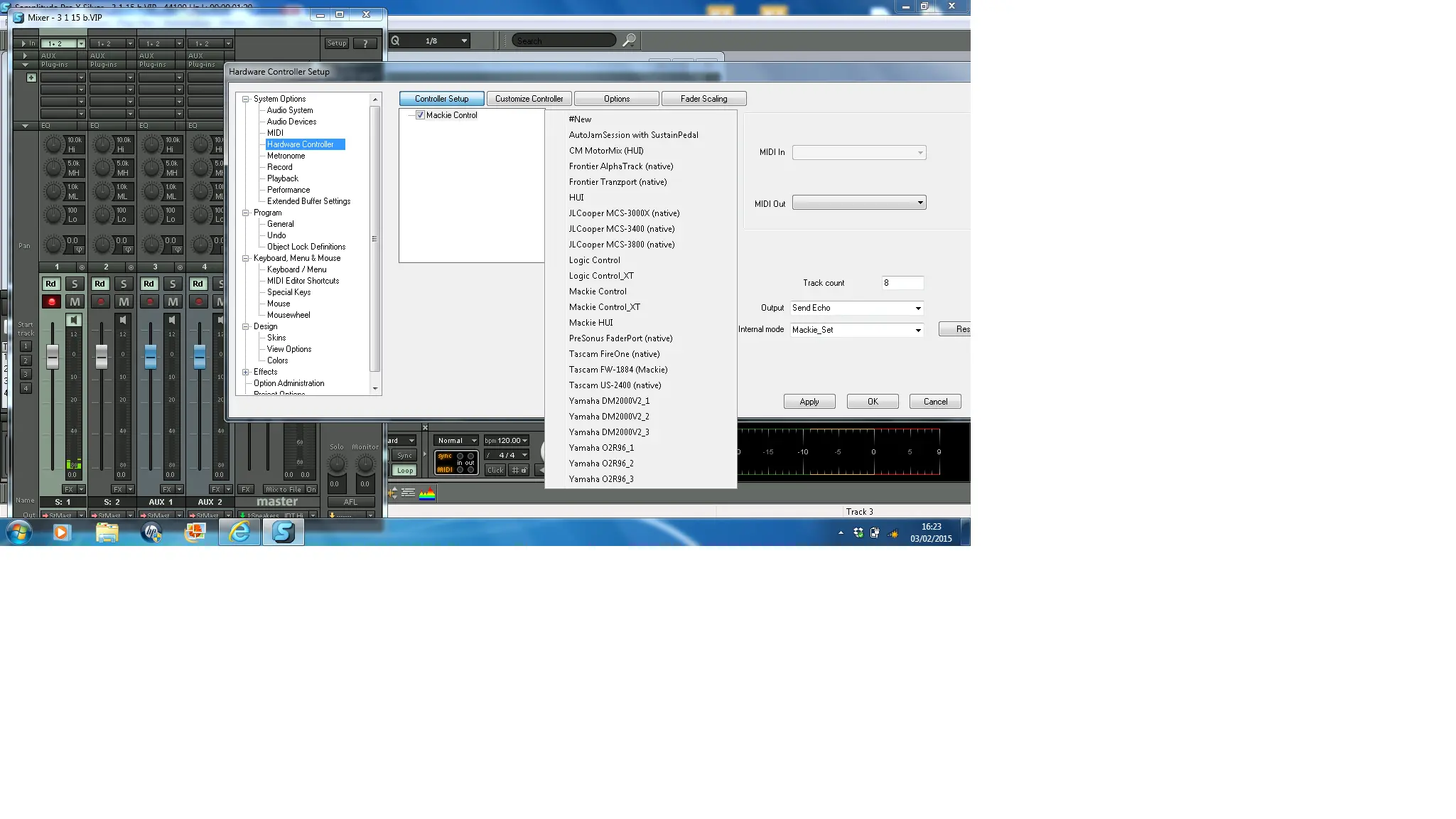

I also strongly suggest you download the trial version of Samplitude ProX. That has a much easier (to me anyway!) MIDI controller implementation setup in it. (once installed, setup a track, mouse cursor on a blank space, hit the "Y" key).

It's not that I think Samplitude will work any better, just that the setup for a MIDI controller seems a lot simpler and more logical than Cubase?
I am guessing you would set for "Mackie Control".
