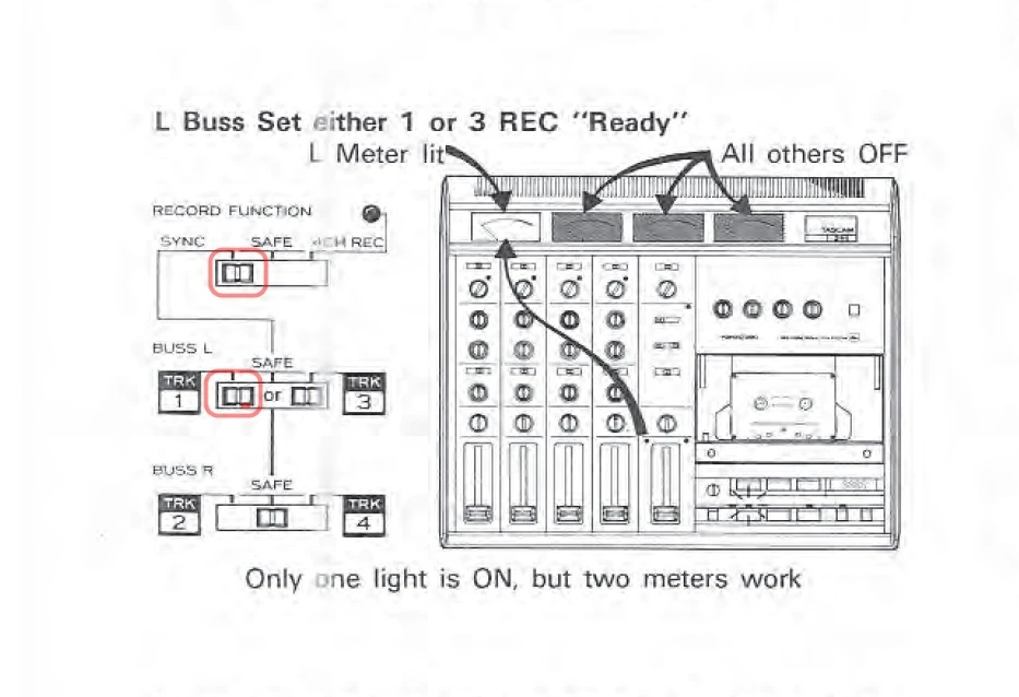

I have an old 246 that I think is sort of similar, but haven't used in a long time. It sounds like no tracks are 'armed/ready' to record which may result in the blinking record light. When you say the 'numbers start counting', I'm assuming the heads have moved to engage the tape and tape is rolling in the transport(?) To set up a track to record do you have the switches set as shown below?(been a long time, I think this is correct)

yea i had the switches exactly like that but it the record button just doesn't respond, every button responds exactly how its supposed to but the record button
