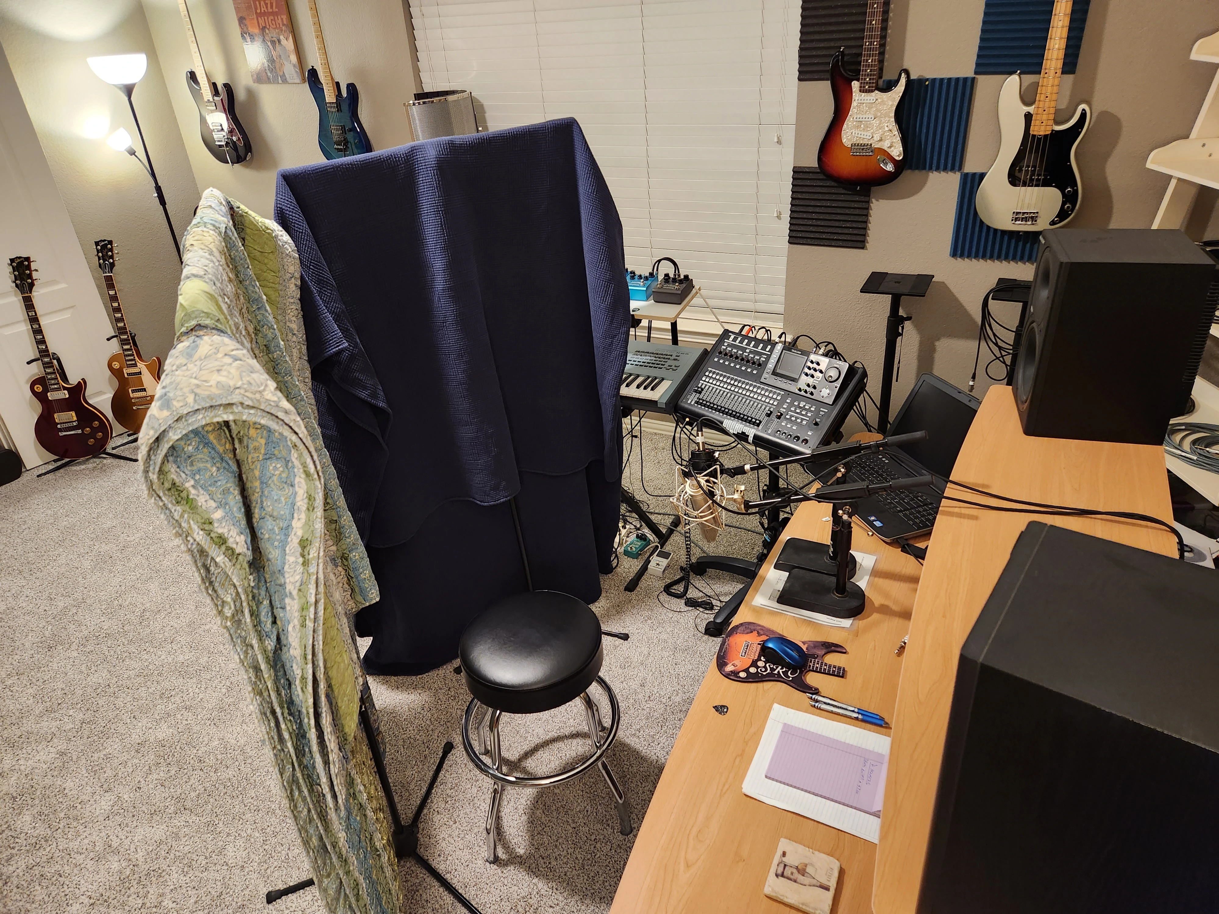

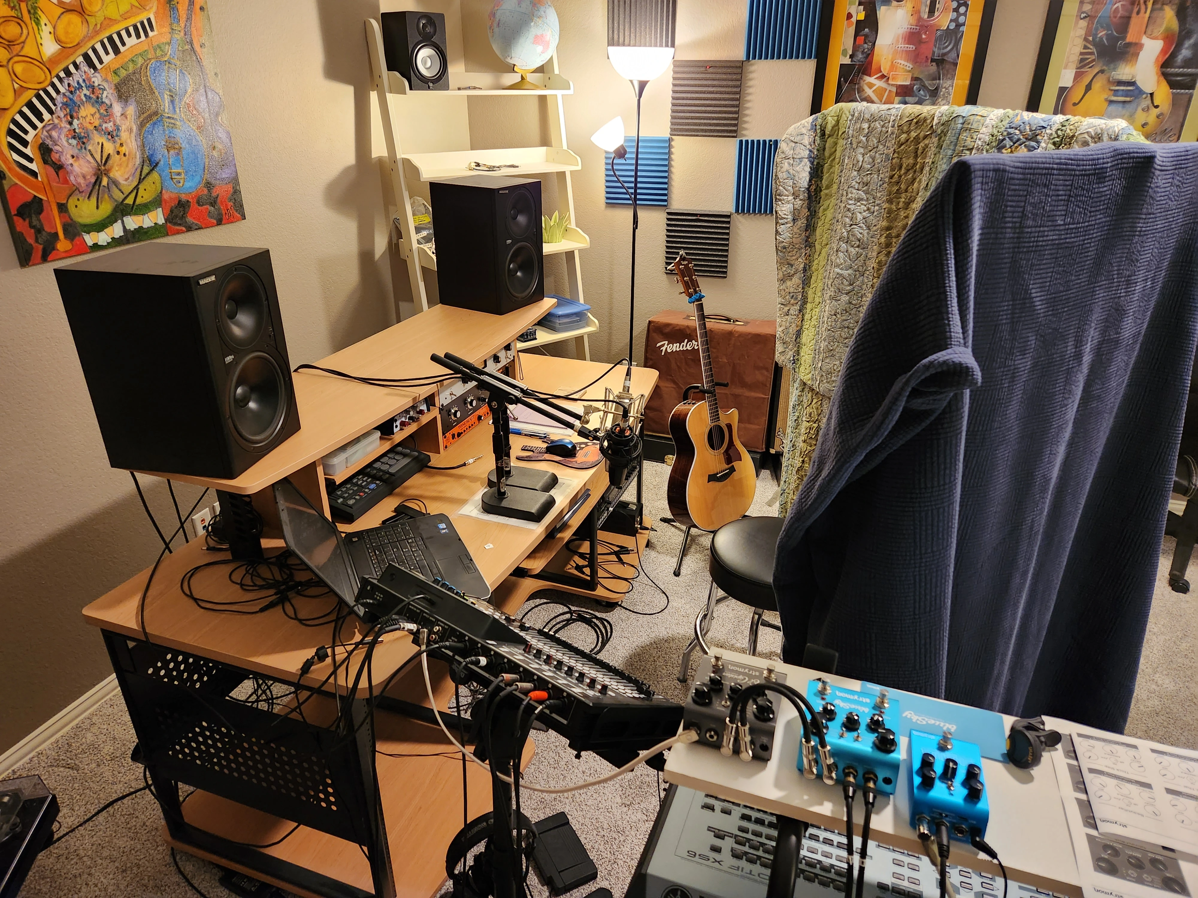

I've been experimenting with recording acoustic gtr in a semi serious way for several years. And I've got my go-to single-mic approach pretty well down considering my room, mics, preamps, etc.
I've played with and experimented with all sorts of two-mic "stereo" approaches - x/y, mid-side, 12th fret and over-shoulder, etc, etc. I've tried all kinds of stuff with varying degrees of "success" and/or satisfaction. But more recently I've settled on something fairly simple. I simply take two mics - in this case it happens to be a WA14 and a WA87 - and I put them as close together as I can get them and set the depth of the capsules for near perfect phase alignment - both pointed roughly at the 12th fret/neck-body joint - approx 10-12 inches away. Needs minimal EQing if any - and little-to-no compression - depending on what you're trying to do. Pan to taste. Max wide split sounds great, 9 and 3 sounds great, 10 and 2 sounds great. Very happy with this so far. YMMV.
The moral of this story is.... tons of experimentation with your setup and your gear is worth it.
