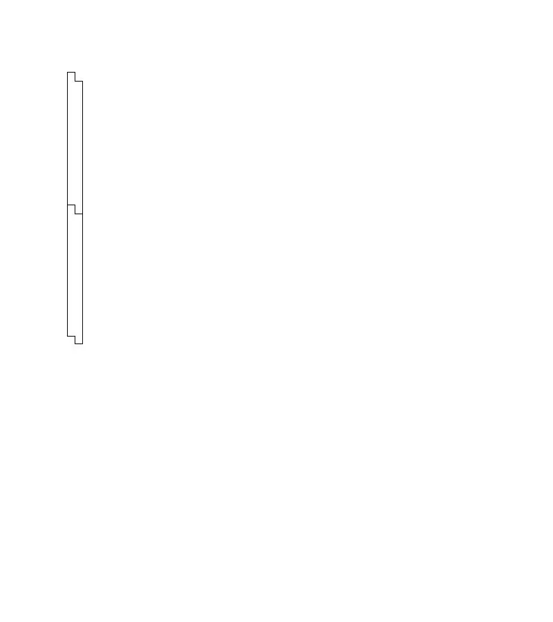

There's a real good chance that the 1x6 siding you're looking at is what they call "ship lap" or lap siding. It was made to keep the cracks from showing clear through. It was shaped, looking at it from the end, like the drawing I've posted. (oops, forgot to attach, here it is)
If that's what you have (or not) you would need to caulk EVERY crack in it before putting anything else on the wall - then, a couple layers of 5/8 sheet rock snugly between each pair of studs, caulked at the edges and screwed (not glued) in place. Be sure not to use too long screws, especially for the first inside layer - you don't want the screws to penetrate into the stucco or beyond.

Here tiz...
