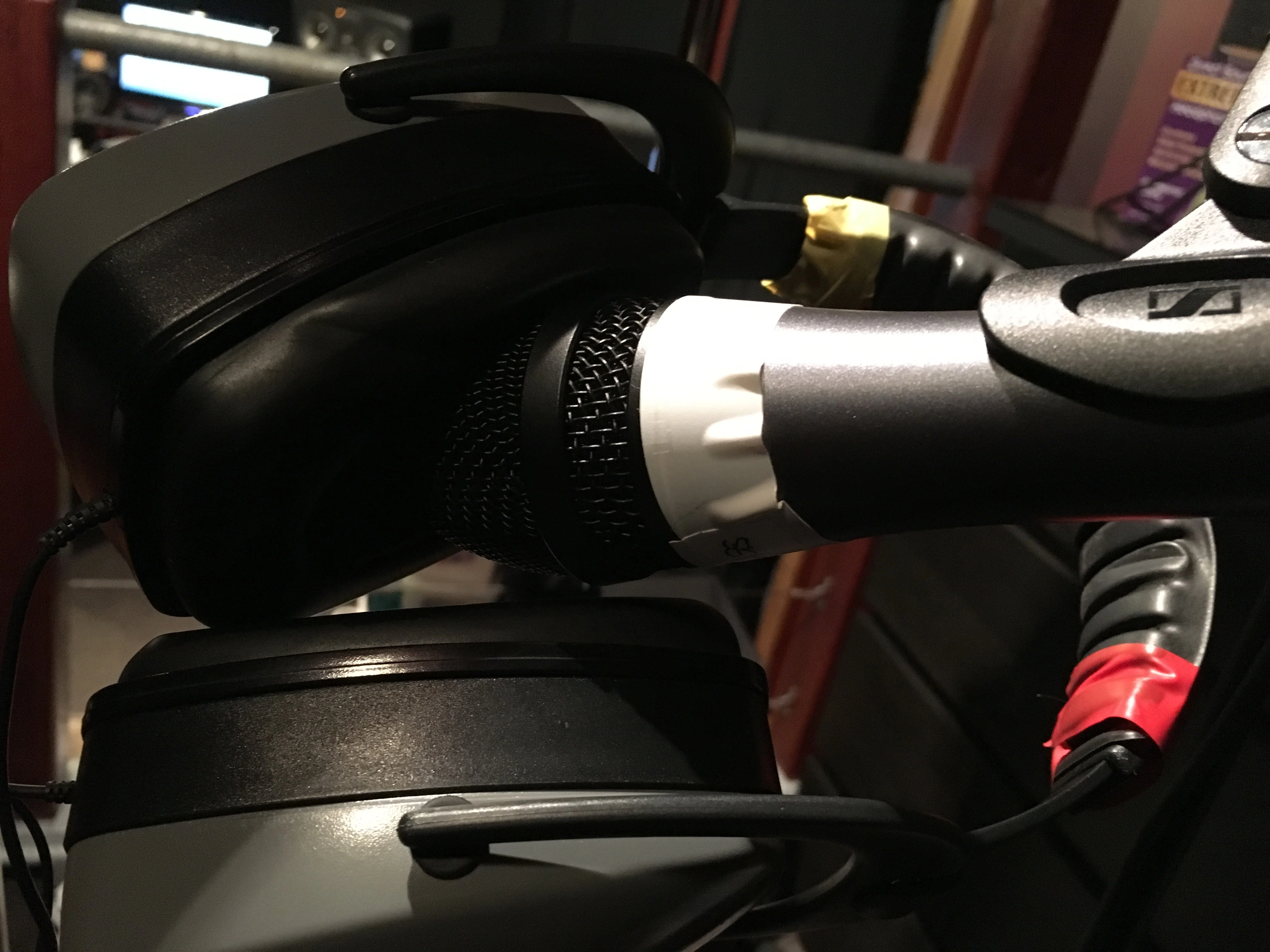

Hi all
For those of you who like to experiment with your recordings, give this a whirl....
Was fooling around with a really crappy sounding live performance DI bass recording & wondering how I could re-amp it at home to make it sound fuller (I don’t own a bass amp)
It needed to be compressed, EQd and be subjected to some actual speaker and air movement to improve the thin, toppy sound of the DI signal.
In the absence of a bass amp to use, I came up with the crazy idea of sending the track out of the DAW into a compressor/EQ unit then into a pair of headphones, hanging one earphone over the end of a dynamic mic and recording the very close mic signal back into the DAW via another compressor/EQ unit.
Surprisingly, it actually worked out pretty well.
(I took a picture of the headphone hanging over the end of the mic just for fun but I can’t upload photos to this forum)
Afterwards, I realised I have a keyboard amp somewhere that I could have used which would have been much better. Oh well.
Happy experimentation!

It a damn good thing you didn't try that with a condenser, and for the same reason you NEVER drape headphones over a vocal mic. The phantom power fries the drivers in the headphones.

Well, the keyboard amp has a larger speaker to move more air for better low end response...a little more "fit for purpose" than a headphone speaker :)

Ah...found it
Hardly worth the effort LOL!

That ^ is completely misleading bollocks.
Yes, love a bit of experimentation me. NB. Headphones won't give a decent bass response unless sealed to the head. (think speaker chassis, no cabinet) One solution is a cardboard box (wine boxes are good and for two reasons!) about "head width" Punch a couple of ~50mm holes each side and loosely fill the box with absorbent, cotton wool, old socks di-da. NOT forgetting the microphone!
Also, if you are careful with levels you could re amp through a monitor or even a hi fi speaker but you MUST keep levels in check!

Thank you and +1!!! Though on this side of the pond we'd describe it as excrement rather than testicles, they both come from the same animal. ;)
I'm not sure I agree with your cardboard box idea. Like, we have the term "boxy" for a reason.
Another way to get more bass response from the system would be to varispeed the playback up an octave or two, then slow it back down after recording. In fact this would also push the high end closer to the limits of the drivers much more like a typical bass speaker. Has the added benefit of taking less time to accomplish.

Thank you Ash' and No! Cardboard has high internal damping and did you miss the bit about the stuffing? The vast majority of speaker cones are effectively cardboard!
