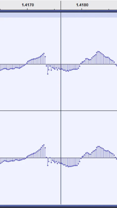

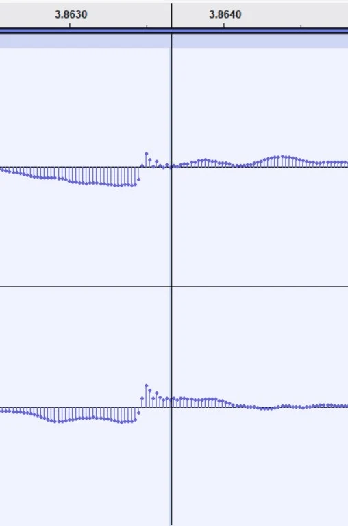

Audio clip examples of "tics" from a recent vocal track. Tic example #1 Tic example #2
These examples were extracted from a vocal track that was recorded using the HP laptop ON BATTERY, and of course the PreSonus interface and an AKG P220 mic
And yes, the battery was fully charged, for what that's worth.
I thought I still had an example of a tic in a guitar track, but I don't have that file any longer.
Looking at the two files, they look like buffer overruns to me. In both cases, a portion of the wave file is missing. If you look at the wave forms, they are consistent until right at the clicks. You can load the two tracks into Audacity and reference the two points and see the wave forms before and after.
Here are two of the clicks.
First track _____________________________Second track
You can try upping the buffer (go from 128 to 256). You don't need to go all the way to 1024. Also, make sure you have the latest driver. Is your interface the Audiobox 96? If so, the latest driver appears to be Universal Control v4.5.0.102825 .

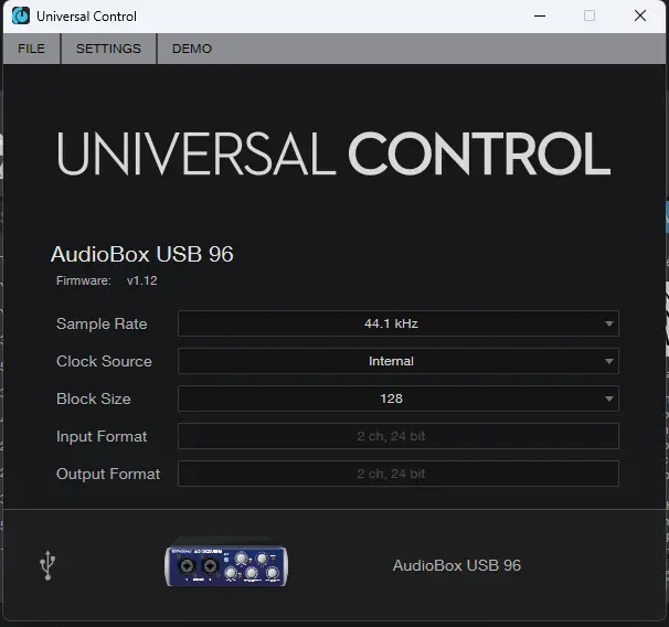

OK, Talisman, I may or may not be understanding what you're saying, but let me show you the only other controls I commonly use when recording/playback. And what I do was recommended by PreSonus Support.....which I mostly trust. They know their product but I don't think they're always honest about admitting to bugs in the system. Anyway...there is the Universal Control which sets the Block Size. At 128 I'm hearing minimal latency from input signal when recording and not noticing any signal dropout:
And the Audio Set up window mirrors my Universal Control setting:

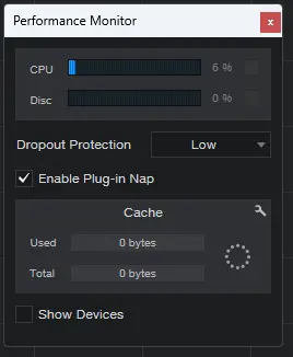

And in another window, I do have the option of dialing-up dropout protection:
Regarding the Block Size, I record at 128 and listen to playback at (I believe) 2048 or something like that. RECORDING AT 2048 CREATES HUGE LATENCY, just like a digital delay effect.

Live recording at 2048 will be a big problem. Try moving the block size up first to 256 (that usually isn't bad, then keep moving up until it stops). When I use my USB, I never go lower than 256.
DM60, I never record at 2048. I use that block size only for playback/review. Recording, I notice way too much latency at 256.
I could never get mine below 256 without a lot of noise. But I could live with the "slight" latency. To me it was more stereo/chorus effect at 256.
With a 256 buffer, you shouldn't be hearing "way too much latency" at 18ms (~9ms in and ~9ms back). That's equivalent to you standing less than 20 ft away. When I was playing on stages my amp was almost always at least 15 ft away, and the drummer was at least that far. We never noticed any timing issues.
One thing you can try (don't know if the system will handle it) is to up your recording frequency to 88 or 96K. That has the effect of halving the latency. I'm going to assume that the computer can handle the data rate. Then it's a matter of how well the Presonus driver is written.
I don't have a clue what the dropout protection setting does, but there's no harm in upping it to high for a test.
