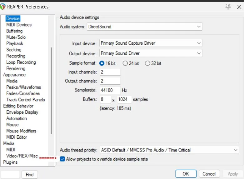

The first thing that I would check is if Reaper is set to override your settings in the ASIO. It's under the preferences - devices. This is the setting on my email/browsing computer (no interface, just the soundcard). Notice the red arrow pointing to ALLOW PROJECTS TO OVERRIDE SAMPLE RATE. Make sure that your settings are set to ASIO, with your buffers at 128 or 256. Reaper will adjust the interface if you want it, but you can uncheck the box by the arrow and you'll always use what Focusrite Control says. But you want them to match.
Oh yeah, the manual offset is fine if you have a good way to exactly measure the latency, but Reaper will usually adjust things correctly on it's own. I don't bother with setting it manually.
Thank you. I'll work with it again, tomorrow. I don't know about that ASIO thing. I'll have to look into it.
