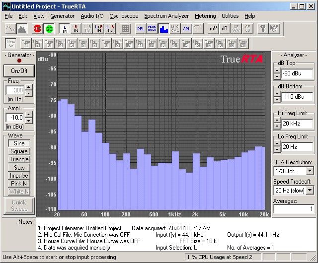

  4. What do you make of the screenshot below? Is the noise floor too high to do an effective analysis of the power supply rails?
Honestly I can't follow your setup, it's too confusing. However, 100nF into a 10K line input won't work too well, that's a 160Hz corner. Ideally you have a really high input impedance amp, an instrument input should work better than a line input. Then you could keep the 100nF cap. You don't need to worry about "loading" an input (that's backwards really), the PSU impedances will be quite low on account of their caps. Instead, the PSU is a "signal" source that you need to keep unloaded to get a useful measurement.
In related news, I opened up an RME unit to troubleshoot a bad channel, and it had a switching PSU (looks like something they bought, not built) that has 400uV ripple. As appalling as that sounds, it's not the source of the problem, most of the channels work just fine, and the unit has 113dB dynamic range . . . I did not analyze the spectrum, since normally I would use the RME to do that, but it's possible much of that noise is out of the audio band anyway. Or not. But that's a pretty good demonstration of an IC's ability to reject power supply noise.
Awesome. That makes two of us then. :D No sweat. I understand.
Okay. I'll use the instrument input on the Digimax FS then...1mOhm input impedance.

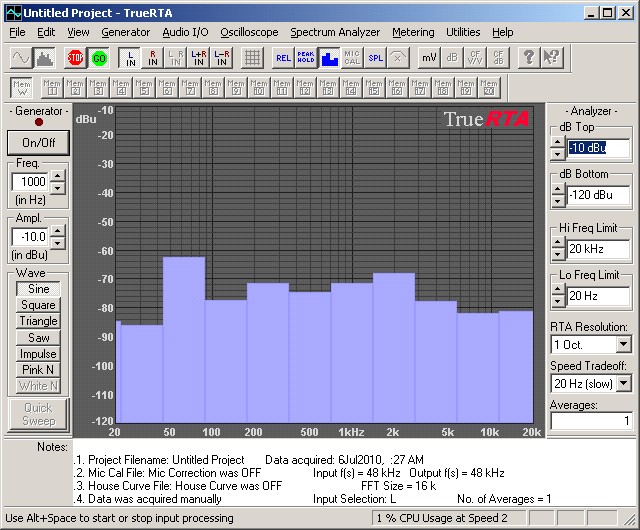

Here's what True RTA revealed of this input path with the input unterminated:

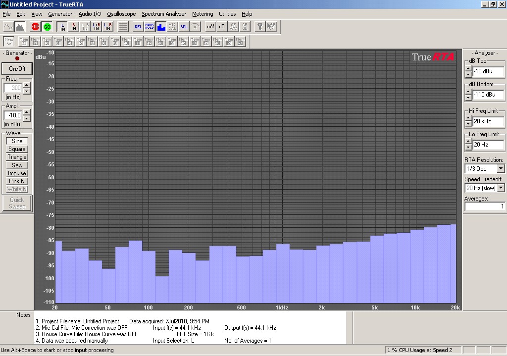

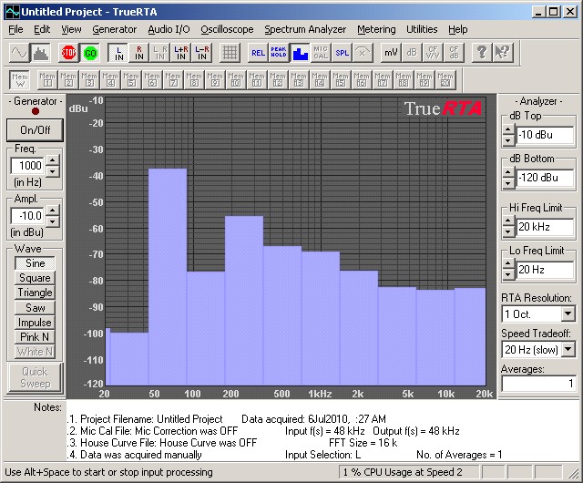

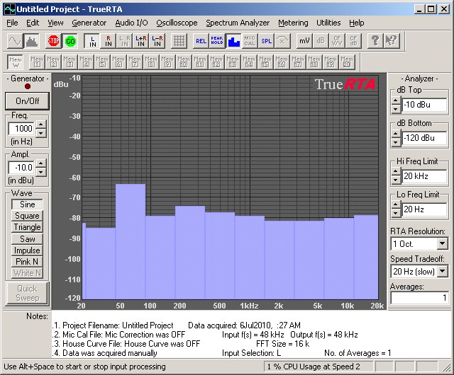

Now, here is the +48VDC rail:

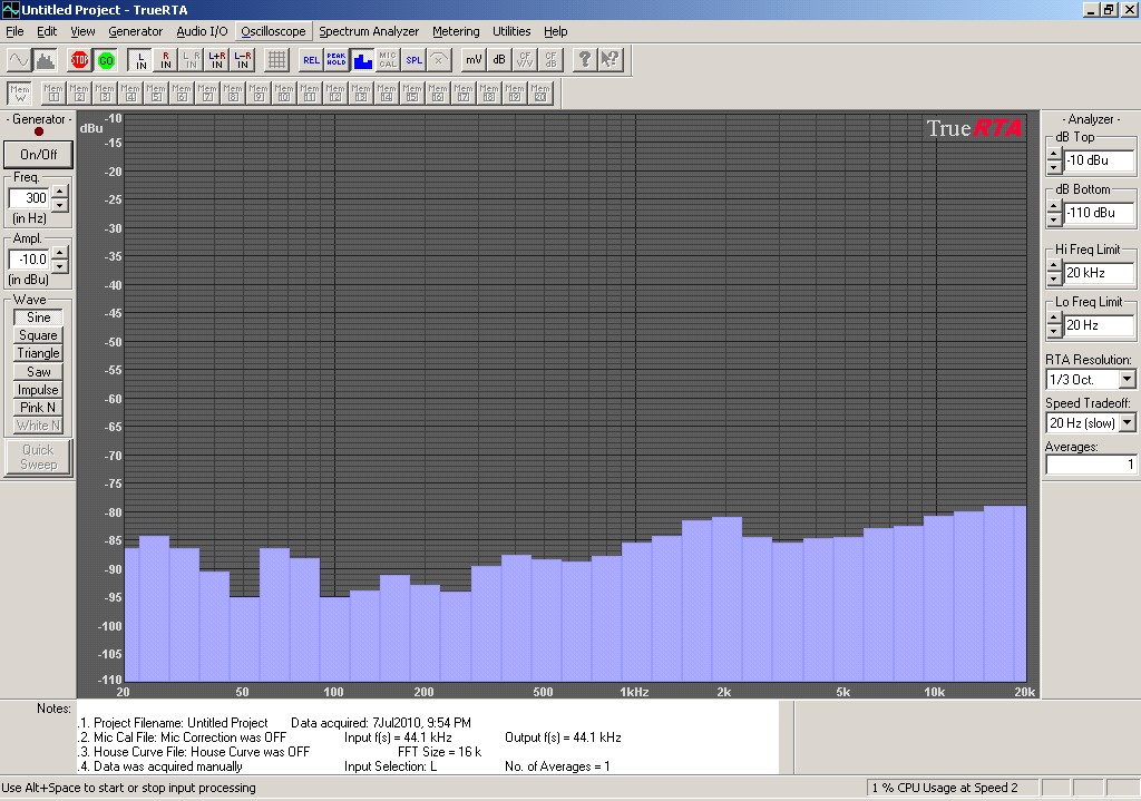

Here is the +24VDC rail:
Here is the +17VDC rail:
And finally the -17VDC rail:
Comments?
What's the dBFS to dBu calibration? I mean they label that dBu, but I'm guessing it's really dBFS. The spectrum looks usual, even at that very low resolution, basically white with a bit of 60Hz hum. Integrated noise would be ~40dB higher than spectral noise, so if I take a wild guess that +20dBu = 0dBFS, that means noise is -60dBu (1mV). That does seem higher than it should be, so I would investigate your methods further. I'd especially like to verify that calibration, and obtain a better resolution FFT so I could see if that is truly white noise, or just a lot of induced hum throwing off the measurement.

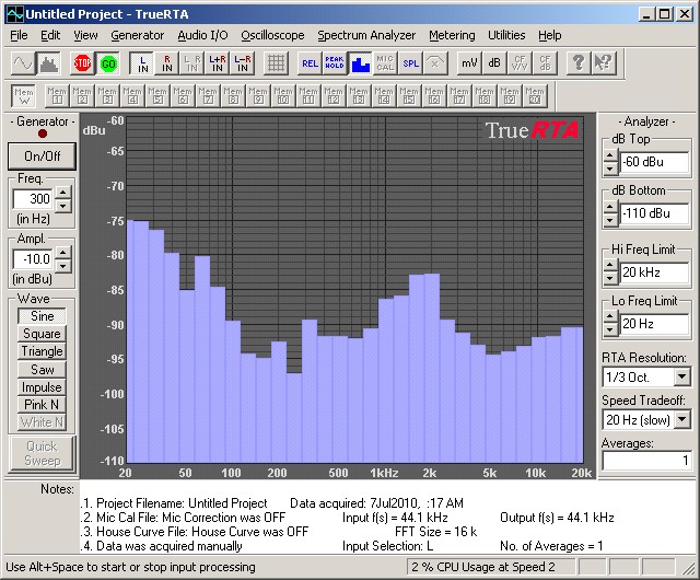

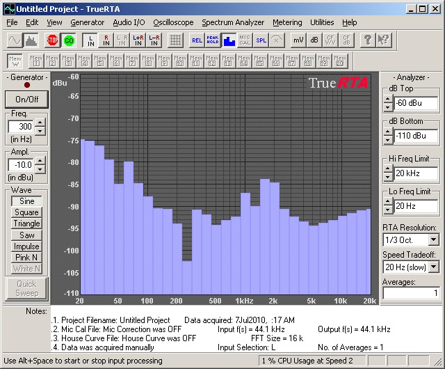

So I fear I'm going to have to get ahold of a cleaner analog WDM interface for when I'm using True RTA...here is the terminated instrument input on the Tascam US-224 after calibrating the input and output...connected to the Soundtracs MX +48VDC rail output but the PSU is off, and the other end is connected to a Hi-Z input on the US-224:
As I mentioned above, I calibrated the inputs and outputs...here is what a -10dBu 300Hz sine wave looks like when produced at the US-224's line output and terminated in one of the instrument inputs. Output level trimmed to about 1:00 which yielded 245mVAC RMS and input trim at MIN, but True RTA compensates, so as you can see its doing what it should:

So, yeah...I'm thinking I need a cleaner input path and using a line level input would help that, so I need to change that cap out. What should I use there?? Type and value??
Comments?

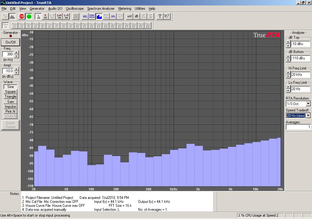

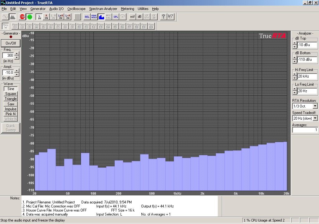

So here are the final screenshots before diving into this thing. I must say that I'm pretty pleased with the noise performance as-is but I'm going to go forward with the mods on the PSU for a couple different reasons...I already have the parts and instructions here, IMHO the stock heat management is pretty sad, and in the end the mods couldn't hurt. :rolleyes::D
So these screenshots were taken using the US-224's line input...
unterminated calibrated input:
Terminated input (connected to PSU but PSU switched off):
+48VDC rail:
+24VDC rail:
+17VDC rail:
-17VDC rail:

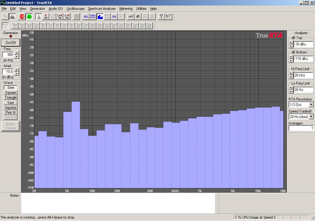

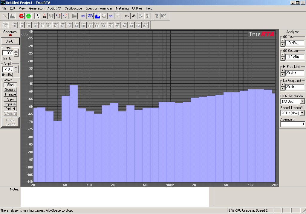

Here is an FFT of a main output passing system noise. As advised, all 32 mic amps are terminated with a 150ohm dummy loads, the mic trims are at max, the channel faders are at unity, the master faders are at unity...I measured 2.5mV with my Fluke meter at one of the main outputs:
2.5mVAC RMS equates to about -49dBu...the FFT graph doesn't show that but I'm assuming that the way the meter reads voltage is some complicated summing of the audio band.
So I see line noise there but this was done in a room full of flourescent light fixtures. STILL good IMHO for having 32 mic amps open and trimmed to the maximum gain.
Here is the same thing except instead of having all 32 channels routed only to the main buss I also routed each channel to all subgroups, set the sub faders to unity, set the prefader level pots to "7" and dumped the subs to the main buss. Great way to make noise...about 9mVAC RMS of noise...did better than I thought it would:
