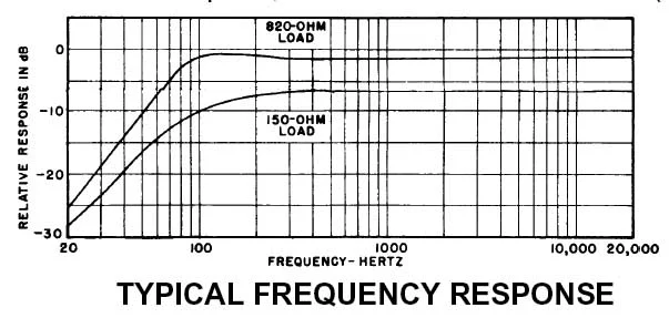

A high pass filter basically "rolls off" the bass frequncies at a given slope below a certain frequency - it would decrease the lower frequency amplitude (typically below 100Hz) of your signal. It can be used to decrease the proximity effect, or boominess in an accoustic guitar, etc.
