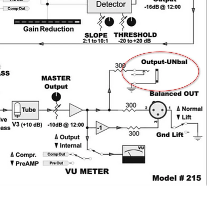

You didn't say what type of cable you were using for the hookup. I also have an ART Pro Channel and 2488NEO. I use and XLR-F (female) from the ART to 1/4" TRS which is usually plugged into one of the combo jacks, but could be one of the other 1/4" Line inputs as well. This maintains a balanced connection between the units.
If you should use an XLR to connect the ART and still get hum, it appears there is a ground lift switch which may reduce or eliminate the hum. A TRS plug in the jack I circled could likely be a hum maker.
If you're using a 1/4" TRS to 1/4" TRS to interconnect the two devices, it may be possible to get hum if the ring connection at the ART doesn't connect to anything in the TS unbalanced jack.
I'm using mic to XLR to ART to XLR to Tascam. Yup, it's still the 2488NEO. Now that the weather has warmed up, I'm trying it again.
