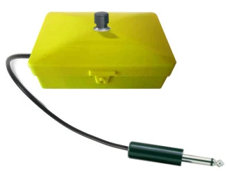

here's DIY-it :)
All you need is a some sort of box,
then one of these:
http://www.radioshack.com/product/index.jsp?productId=2062496&cp=&sr=1&origkw=push+button&kw=push+button&parentPage=search
pretty much any cable will do and 1/4" mono phono TR plug
http://www.radioshack.com/product/index.jsp?productId=2103992&cp=&sr=1&origkw=phone+plug&kw=phone+plug&parentPage=search
if you have any spare mono 1/4" plug TR cable, just cut off on one side, connect to the push button's terminals (it does not matter which is sleeve which is tip. Mount the button into any toy or soap box or what ever you may find and there you have it.
Just dont step too hard on it, - top it easy :)

here's the device:
