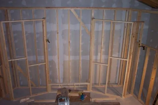

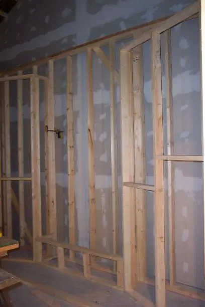

This is the Control Room rear wall. The angled framing that you see is essentially a mock-up to make sure it fits well, and to line out any "nailers" that will be needed to attach these bass traps to the finished wall.
Here's a floor level view of it. As you can see, their just attached to the wall by clamps, again, this is a mock-up to ensure there's no surprises when it comes time to attach them.

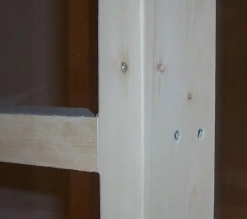

Everything on these partitions is screwed and glued - makes for really nice joints.
I think the key here is to sand the lumber you're working with. It sort of solidifies the fact that your really building cabinets, and not framing walls. Not to mention the fact that you don't want any "splinters" poking through your delicate cloth covering. Sanded 2x's have a tendency to weep sap too, so, they'll get coated with a quality sanding sealer as well.
Oh, and of course remember the old adage: "Cut twice measure once" ... I mean...errr... umm.... Well, actually, that about sums up my approach! :p

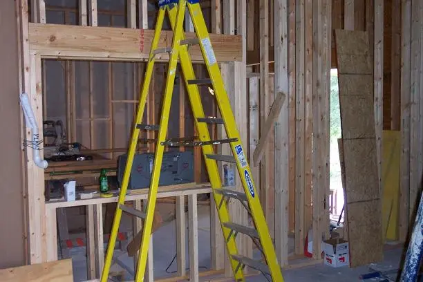

This is representative of the chaos that currently is my live room. :(
