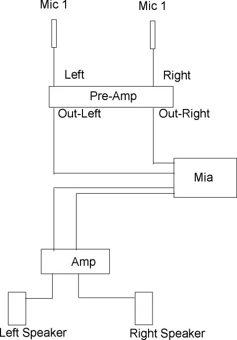

Are you sure you have your cables and sequencer program set up properly???
The Mia naturally lets you monitor while recording; no special button-pushing is neccesary.
The inputs and outputs of the Mia are mono, yes... but it's a stereo pair. One is left and one is right.
You will need either powered speakers, a stereo amp with speakers or a headphone amp to listen to the output.
Kinda like this attached pic....
