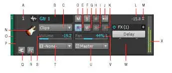

I did that , but I only hear a feedback terrible sound. I can record guitar , but can't hear me in real time sound. After 2 days of trying I get it with that. ( Record with not hearing myself)Are you an experienced Cakewalk user? There's a monitor button ("input-echo", labeled J on the diagram below) you have to select on the track to hear yourself in realtime through the VST/plugin.
