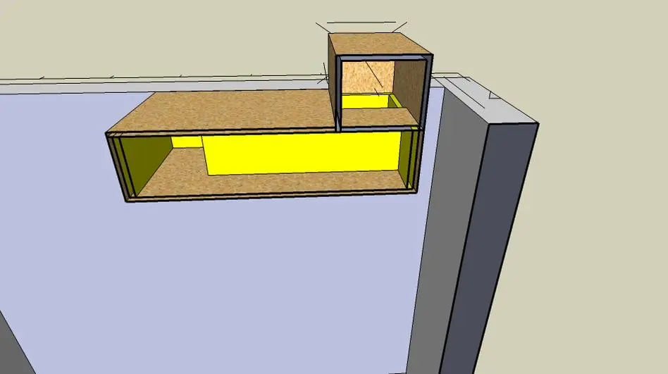

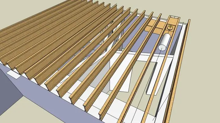

Looks nice, Rick. Always interesting to see my studio in 3D :)
One thing to keep in mind, I have limited ceiling height. The room you have the one baffle in right now has about an 8 foot ceiling, but the room below it (the smaller room) has a shorter ceiling. The good news is, in that room the baffle can be tucked up into the ceiling because there is clearance between the i-beams and the lowered ceiling.
It was lowered to get around some plumbing and HVAC ducting.
My father-in-law is dropping off his extra supply of 3/4 OSB and plywood today so I can start building baffles!
Jim
Hmmm, isn't being IN IT 3d?:D(just kidding)
Thats the difficult thing about trying to extrapolate info from plans and pics. Theres NEVER enough info.:o However, in the drawing(which isn't finished) I was actually going to extend the baffel to appear as another SOFFIT, with BOTH supply and return baffles within. This way, you could simply RC over framing around them. Anyway, its an idea. But I didn't know ceiling heights.

Any idea when you might be done with your drawing? The only reason I ask is that I'm quickly approaching the point of needing to do the HVAC work before anything else can continue.
Well, if you are going to USE my design, then I'll finish it asap. Otherwise, it was just an exercise to learn more of Sketchups potential and illustrate a possible solution. But yea, if you want me to detail these, no problem...except for the custom "boots".
ie...at the register/grills to the box and duct to box connections. I don't know if the flex duct actually needs a "decoupler", but since the grills will be integral to the drywall TL envelope, they need to be decoupled. The box itself MAY need "decooupling" as well, so structual transmission from sound entering and resonating won't occur. Maybe Rod can chime in on this.
fitZ
Rick,
Yes, I'd be interested in your soffit design for the one room you were working on especially.
I hadn't thought of building it into the framing and then drywalling around it. But that is EXACTLY what I think I will try to do for that room. Well done.
I don't think the flex needs decoupling, as it acts as the decouple itself. I was planning on doing something (leaving a 1/4 inch gap around the vent area, filling it with backer rod and then acoustic caulk, and then using some sort of gasket for the vent itself.
My guess is that the baffle should be decoupled, but its probably not possible or practical, considering it has to be attached to something and I don't have floating walls.
If you saw my post a few back, I'm going to use my muffler idea for the theater, because a) its something and b) there are other flanking issues in that room that can't be easily addressed. So its going to be more of a "do what I can" scenario.
The studio area however, will have all feeds and returns running through baffles and connected via flex. Basically to do the best I can with my single HVAC unit.
