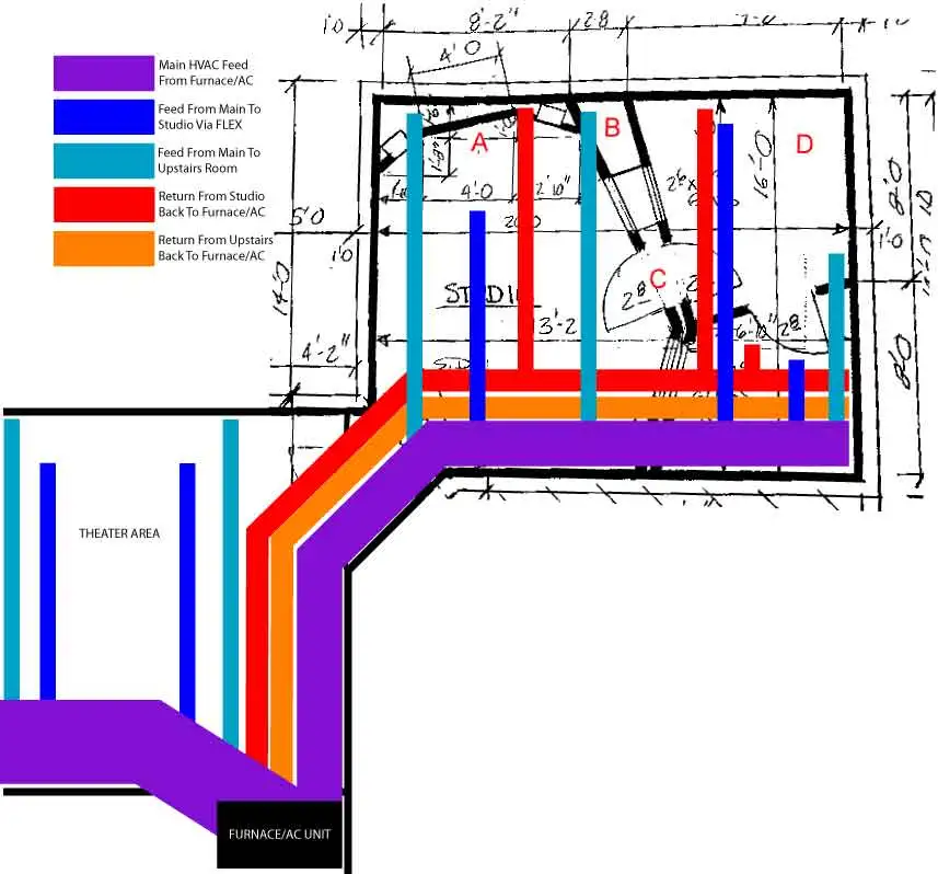

Here's a drawing of the HVAC paths (see below).
The feeds and returns to the studio area are all flex ducting and have some bends and turns to them.
The feeds and returns to the upstairs are all standard HVAC ducting, but could easily be replaced with flex to remove any coupling of the metal boot to the trunk etc.
As you can see, ALL of the HVAC for this end of the house had to fit through that doorway opening. The reason being is that all the other walls are concrete and this is the only opening to the area. It allowed us room to put a separate return for the studio, but not a separate feed.
Jim

Howdy. Actually, to my way of thinking, your "terminology" was dead on:D. Hey, now that plan REALLY helps visualize whats going on. Thanks. This type of info is what I've been trying to pry out of people for years here. It really does make a difference when you are trying to help people with correct solutions. And believe me, when it comes to HVAC, I'm really pretty much of a dunce.:p But maybe Rod will see that and i'm sure it'll help him. If he doesn't I'm sure we can get some answers to the "flanking" path issue. One other thing, I think there is some kind of "decoupling" termination hardware for ducts at the registers too. Don't want all that work in RC in vain.:D

You know, I started thinking about my HVAC situation... since all the ducts run back to the main trunk (as shown in the drawing), that means that sound has to make two 90 degree turns to enter into the other ducts... that should help matters, right?
IE - for sound to travel down the HVAC vent in the studio and then enter into the HVAC vent for the floor above, it would have to make a 90 degree turn out of the studio duct into the main trunk and then another 90 degree turn from the main trunk into the duct for the floor above.
This is of course assuming that the ducting itself isn't leaking sound (which I would assume needs to be a concern.
Thoughts?
Jim

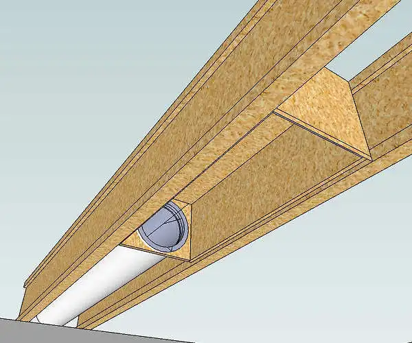

Jim, I'm no acoustic expert, but I believe LF doesn't see it that way. Think "vector pressure". Rod, please correct me if I'm wrong here. Jim, sound is not what you think it is in this context. In fact, its not "sound" untill your brain interprets the vibrations against your ear drum, which is in effect...pressure differences. Normal household sound probably wouldn't have a chance propogating up these ducts under normal conditions. But think IMPACT sounds from a bass drum or LF notes from a bass at 100db. Rod?

Oh, btw, I'm working on it.:D

Working on it jim. Figuring out a "silencer" is NOT easy. Lots of stuff to read.:confused::D I'll get there though. Hang in there.
