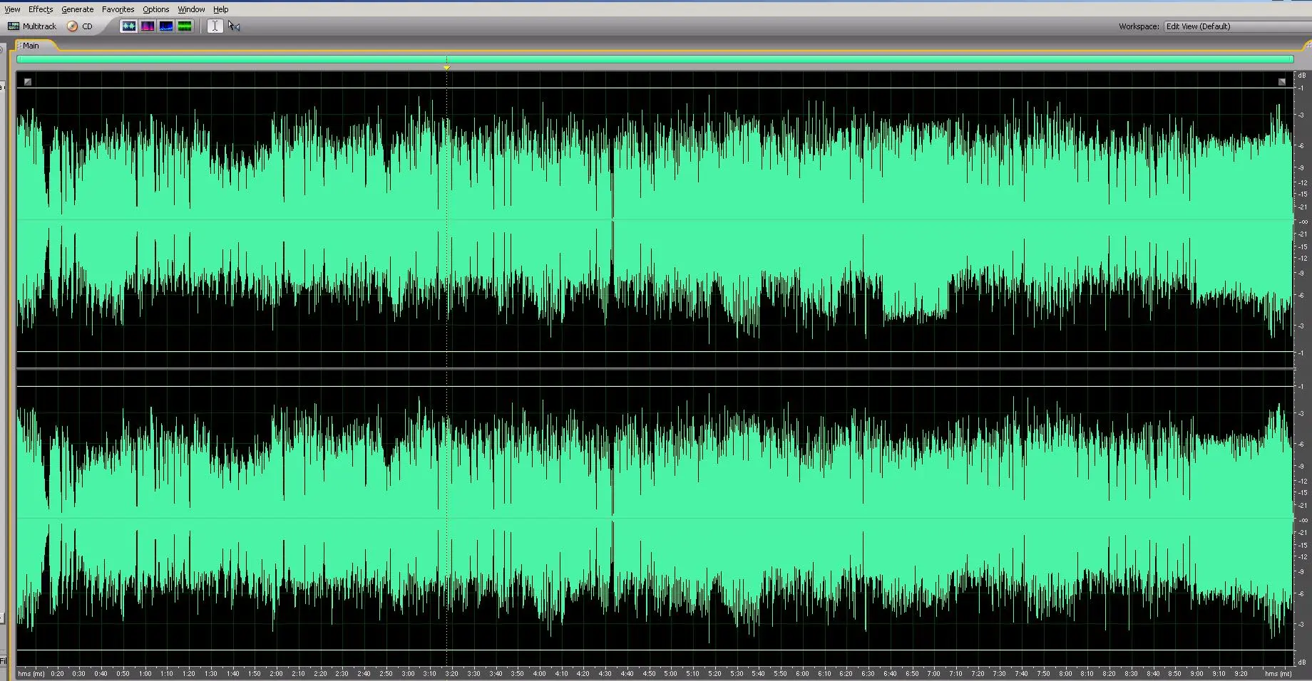

I never said anywhere that I want to squash it and make it LOUD.
I said I want all tracks to have more or less same volume, so when I look at its graphical representation, I do not see extremely uneven picture.
I attached a file. Take a look. This is what I wanted, but I hoped I could get even better results.
Hey Balky,
If you're not particularly concerned about the max volume, just turn down the tracks which are too loud.
Use your ears to judge - That's what your listeners will be using. ;)
If the songs are commercial releases, you should really have to worry too much about them.
They'll be mastered and ready for broadcast already.
For the purposes of podcasting I'd probably set the audio tracks wherever you want them and have them as the benchmark - No additional processing - then work with your voice files to make sure they're on a par.
If you're struggling to get the voice loud enough either turn down all the music tracks, or use compression and make up gain on the voice.
Is that any way helpful?
What I usually do for a simple CD mastering job is pull the louder tracks' gains down to match the quieter tracks' perceived (by me) level then add a mastering limiter on the main bus. I'll apply the mastering limiter until I feel the more dynamic audio suffers then back off.
My podcasts (I call them this way) won't be listened to like normal podcast would. It is for radio webcast. That is why I did not use maximizer hard on it. The broadcast software will do the rest.
Thank you very much for clarifying some things :)
I wouldn't worry too much about the visual differences. Try to make them all sound similar in level and, as you say, let the broadcast software do the rest. It might help to find out if there's a preferred RMS level for program material.
I did find out the RMS :)
if RMS is lower -15, the software starts to do weird things with the sound... suddenly lows diminish, and trebles come out.... volume is sort of unstable...
I tested that file, it is working fine I tried to keep RMS between -15 and -20
