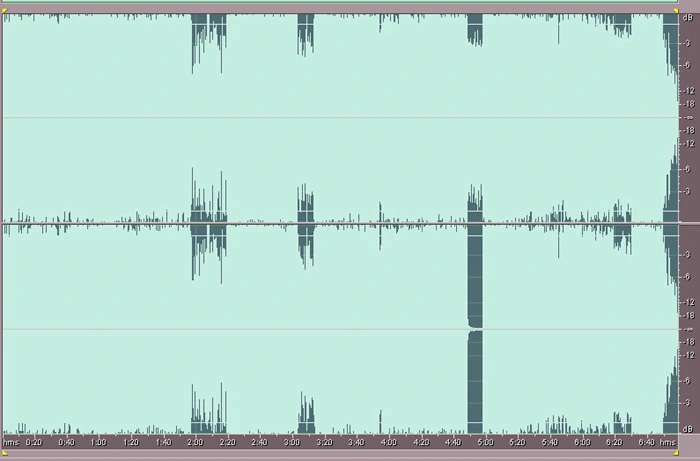

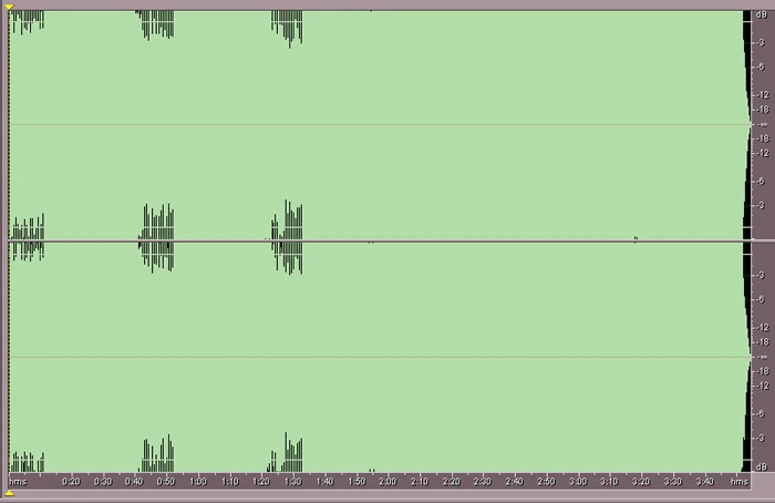

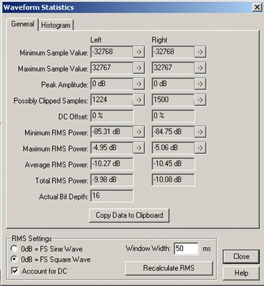

Here are mine and the other persons wave forms "the one that I posted". Look at how my statistics analizer says their peak amplitude is 3.97dB and clips 74418 times. and my wave has a peak amplitude of 0dB and clips 1224 times.
Jason,
What software are you using?
I was using Sonar XL Pro. I would think it wouldn't make a difference, but I'm curious why we have such radically different results.
I also used an oscilloscope being fed by my sound card in both samples, but one can't printscreen from that obviously...
I am using adobe audition 1.0 soon to upgrade to 1.5 in later may.

The sonar pictures I posted was of one of Jason's mp3s, though I don't remember at this point which of the three it was. It was whichever one I was commenting on all along, if that helps. The other mp3 in the sonar pictures was the one I posted... the techno "fruityloops" thing you didn't like :)

I still think he listened to bubble gum though and thats what he commented on directly after my post.
