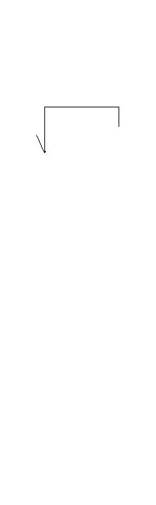

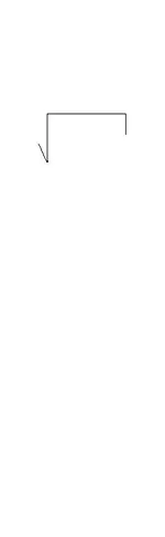

I may have fixed the reverb unit, will have to put it in and see. I took a paper clip and cut it then bent it to shape. I soldered it to the back side of the terminal so it would come up and over the small plastic housing and down and then hooked the spring to the bend I put on the other side.
