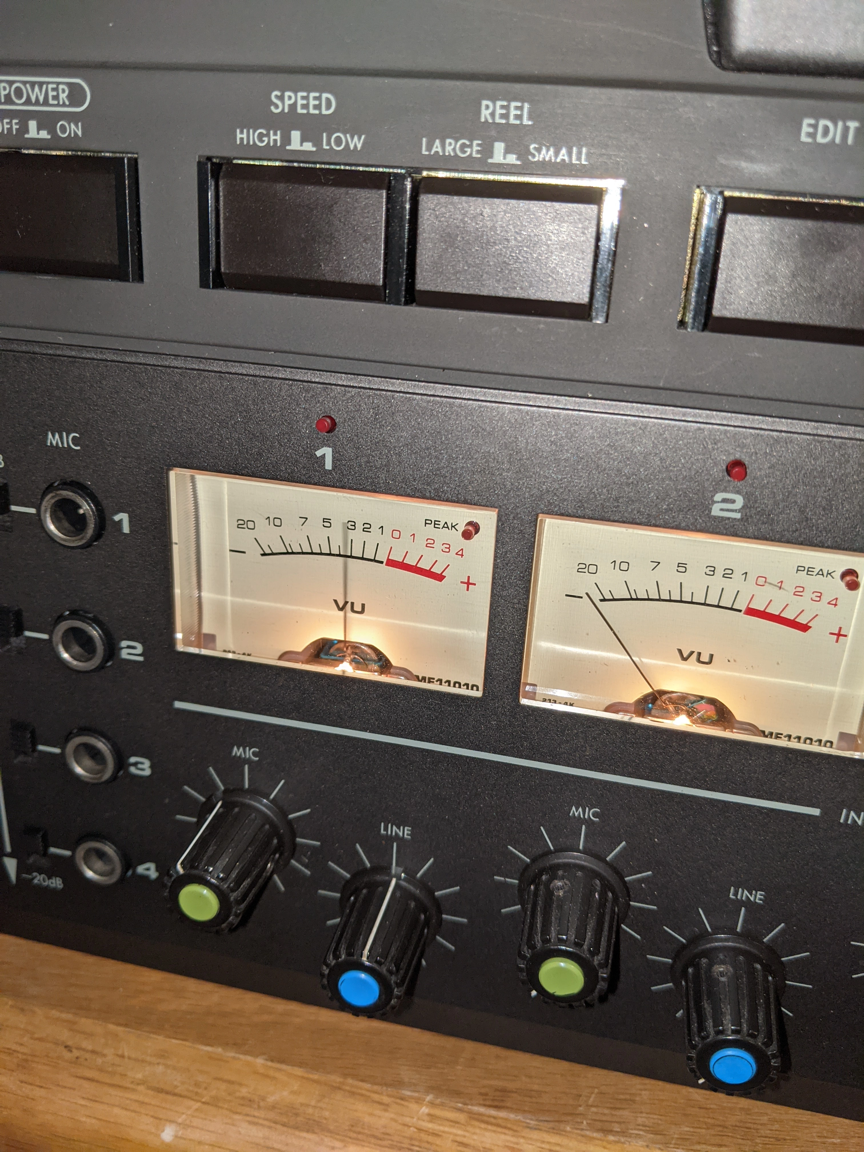

Yes monitor select set to input. Yellow to red is faint and it decreases slightly the lower the line knob. I cranked it. Test originally done at 12 o clock. The switches seem to not have effected anything no

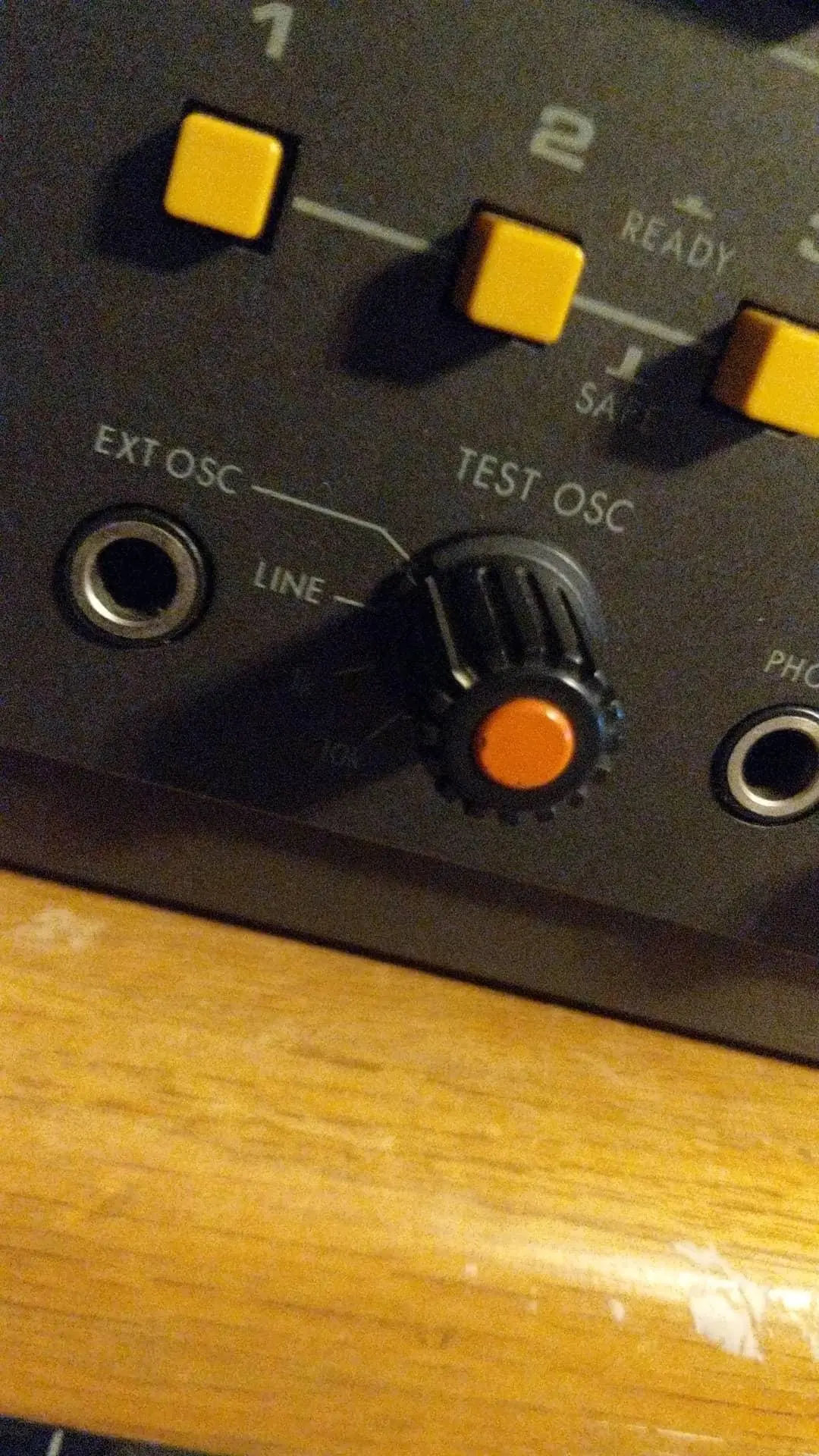

I THINK I FIGURED IT OUT GUYS. I FOUND THIS THREAD AND WHAT HE DISCOVERED INTRIGUED ME. I LOOKED AT MY LAST PICTURE AND SURE ENOUGH MINE IS NOT SET TO LINE
I would like to apologize to sweetbeats for taking up so much time. You and Rob showed excellent patience with me. This is the situation now. The monoprice cable and hosa reverser still don't work. But my XLR to RCA test cable do!!! Red is signal! And the deck is reading it nearly perfectly at 12 o'clock. This deck was calibrated and biased very well for MDS36 and should perform great. It did mic reproduction on initial test incredibly well. Truly a different level than a fostex or old tascam imo. Powerful preamps right on the deck for mics. In the end it was my fault. We used the internal oscillator controls to verify the channel 4 card came loose on shipping and I didn't even notice it had line as a selection or that it was set to only take signal from an external oscillator via that quarter inch input while I was dragging you guys through all these posts. I'm really sorry I feel like quite the moron. Here's the pictures. Hopefully you aren't annoyed and can get a good chuckle out of this. I think this should be in big bold letters in the manual and online for anyone who gets one of these decks to verify they are actually in line mode as I'm sure other users will buy these for the first time from a seller who has already had it calibrated and biased and it wouldn't surprise me if it's shipped left in that mode from the bench unknowingly like mine was. I'm so dumb I can't believe this LMFAO. Looks like I can get away with Jerry rigging some tape return cables and some input cables just fine and get to working. I do have a question though about the tape speed and head life if you still wouldn't mind? I'm of the understanding that running this deck at 7.5 IPS will extend the headlife of the machine by lessening the amount of wear because there's less speed passing across the heads?; The stacks heads have been tested and have full frequency response so they're basically perfect. Because of tape costs this deck is not going to be operated with 10-in reels but seven inch reels of the tape that it's been biased for and the idea is to get as much music out of each tape as possible at a reasonable sound quality so the idea was to run it at 7.5 IPS. With a deck of this quality how big of a Sonic difference is 7.5 versus 15 IPS for multitrack recording? Is the noise floor going to be significantly worse is the frequency was response going to be significantly muddied from running at a lower speed or should it handle just fine? I'm aware that 15 IPS is preferable to 7 and 1/2 but I'm just curious how much Fidelity you can squeeze out of 7.5 with four track multitrack recording from a machine of this quality?:thanks again for your patience and help!
