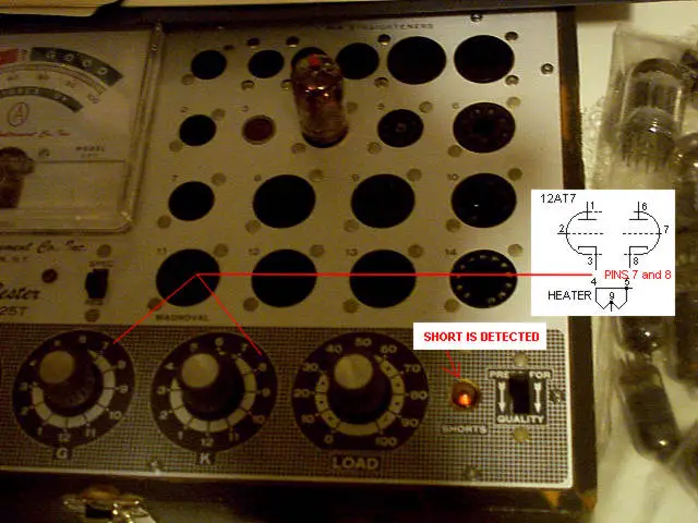

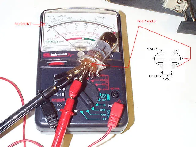

same test between pins 7 and 8. - :cool:

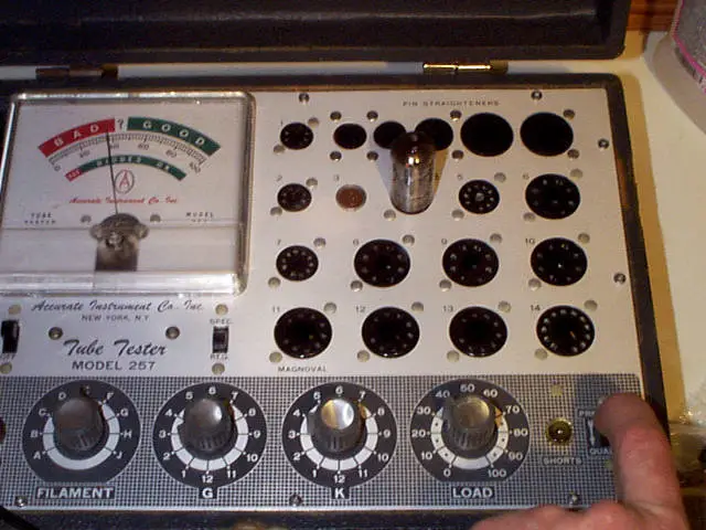

now test on tube tester.
Note: "G" (grid) set to "2" and "K" (cathode) is set to 3 - test between pins 2 and 3 - indicates "SHORT" - indicator lamp glows.
Actually the way it happens is this. When you insert the tube into the socket - at first there's no short indication , but as the heater warms up - the neon lamp indicator starts blinking and then it gets brighter and then glows continiously.
same situation with the "other side" of the tube - pins 7 and 8.
Well, thus this tube is not "qualified" for any farther testing and must be discarded... , or placed into collection of bad tubes :p :D
