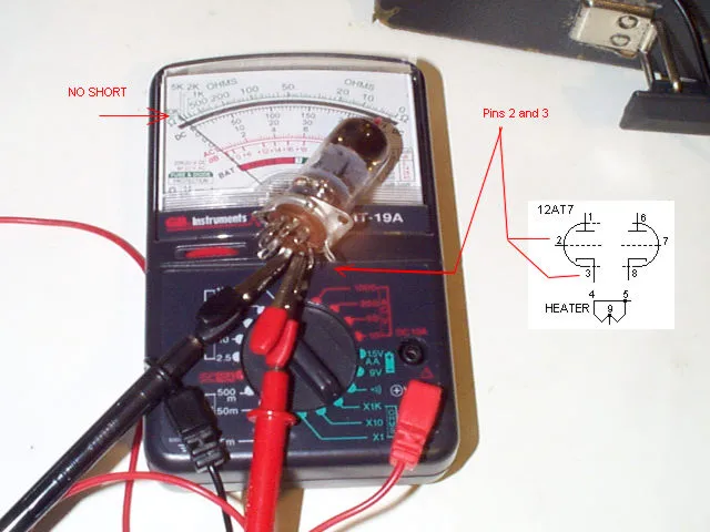

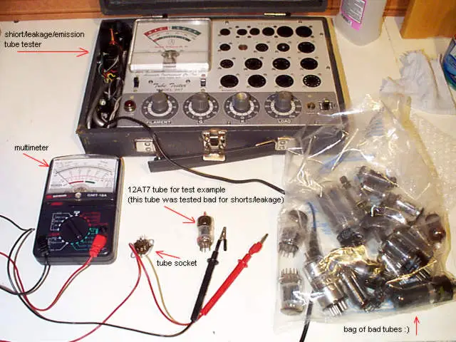

ok,
here's what I have for demonstration.
I've picked out of bad tubes collection bag :D a popular 12AT7 tube that was tested bad - shorts between both cathodes and grids. I am going to use a multimeter first and then I am going to test the tube for shorts (leakage) on a basic emission tube tester.
Let's see what happens.

Here's multimeter "cold test" between pins 2 (grid) and 3 (cathode) of the tube. Set multimeter for resistance x1K. Result - infinite resistance - no short. OK. :cool:
