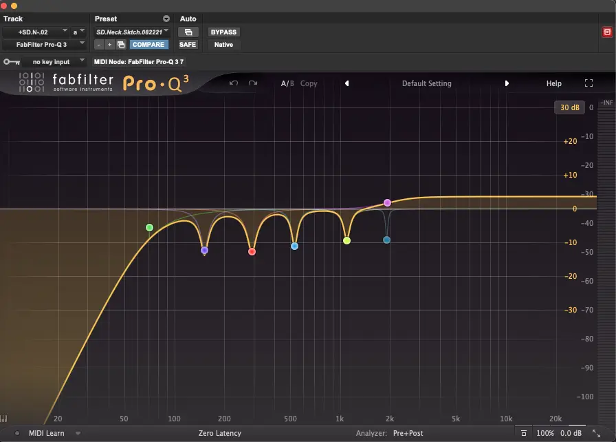

I'm really struggling with the big WOOF in my acoustic recordings, having to EQ the crap out of my raw track to get it reasonably listenable (see attached for my neck mic EQ setting). I'm using an X/Y pair of Neumann KM-184s, having to position them nearly two feet away to cut back on the bass and mids, meaning I've sacrificed the intimacy of close-up mics, which I really like. I run through a PreSonus 32R interface, which does a pretty good job of keeping things clean, and has Gate, Compressor, EQ, and Limiter options, but I avoid using them. I know the risks of treatment on the way into the DAW—that once you record with treatment on the way in, you're stuck with it—but I need an education on what the benefits are. I feel like if I could just get a more balanced signal going in, it would give me more to work with in the mix, less of a bass-mids fight.
I follow some of the better YouTube channels for acoustic recording, but what you don't get to know with these amazing results they're getting is what was done to the signal on the way into the DAW, or after it was recorded, much of the time. Today I set up a track specifically following a Marc Daniel Nelson tutorial, and the result was just a swamp of low-mid woof. What am I missing? Is that just the way acoustic guitars record, even with the best mics, and they require such drastic EQ as a rule? I get the same results with my TLM-103 and TLM49.
So, what are the risk/benefits of pre-treatment as I go into the DAW?
Thanks.

You are using Pro Q 3. Are those EQ points you came up with? Or had you hovered the pointer over the bottom and let the EQ find the points. Fabfilter is excellent at this. The filter automatically finds the harmonics for the key played. Then enable collision detection. Then comparing two tracks a red haze appears, letting you know the area in conflict.
Sometimes I just keep pulling the points down trying to make it as flat as possible. FLAT.

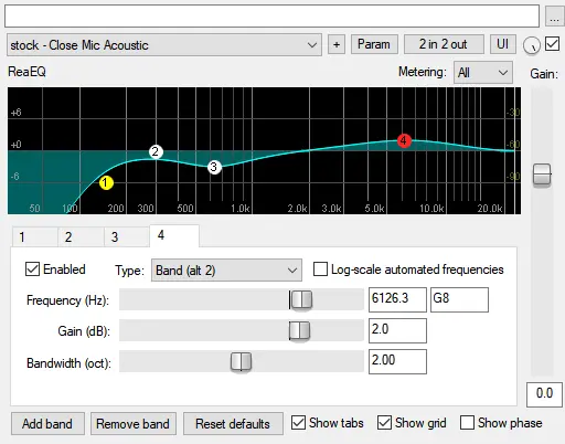

I'm using a Taylor Big Baby with stock Elixir Light .012-.053 Phosphor Bronze. I always start with a Reaper preset. I use this for light to heavy strumming - no finger-picking.
Band 1 = High Pass @ 150
Band 2 = Flat
Band 3 = -3 dB @ 630.1 - 2 Oct Bandwidth
Band 4 = +2 dB @ 6126.3 - 2 Oct Bandwidth

Well your EQ picture is a comb filter - so either your room is whack or your mic positions - I would setup in different areas of the room to see which presents the best scenario - and if nothing in your rooms works try another room - such as a bathroom - still have you recorded your guitars and taken a mix out of the room - to say your car - and played it there? It might be your room giving you false information - in which case a couple of bass traps and some diffusers on the wall would help.
