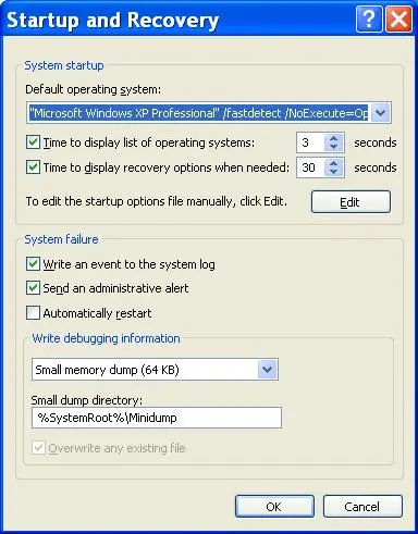

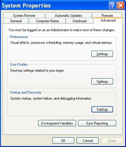

Your system is probably rebooting due to device failure, or a driver issue. Windows XP by default is set to automatically reboot, instead of displaying a Blue Screen Of Death. To better assess what's going on, i would recommend disabling that feature. I included two screenshots to help if you need it, but to do it, right click on my computer and go to properties (or Hold the windows button and press pause break) and then click on the advanced tab ---> Startup and recovery - Settings ---> Uncheck Automatically Restart.
Then the next time it happens, write down the message that it displays. Chances are that it will reference the cause of the problem.
I would also recommend running the scandisk utility, and check both options. After you run scandisk, verify that you dont have any bad sectors. If you do, back up your data immediately ;)
This should get you started in the right direction. Hope this helps.

I was not kidding about the Comp USA issue, they had my computer for over six weeks back in the spring of this year. Anyhow since I changed the fan config and cleaned her out the computer has not crashed all day, as that I turned it on this mourning and it is still up and running, even with Sonar 5 up with a wave file set to loop forever. I did follow your suggestion of the restart configuation. thanks alot.
