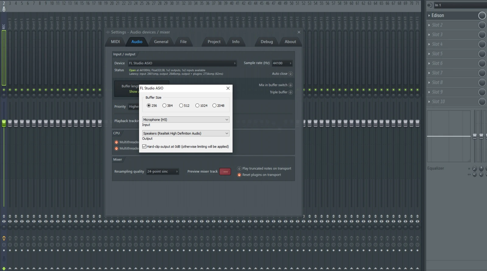

So I'm trying to use the Zoom H5 recorder as an audio interface in FL studio (or any other program for that matter), but the sound does not get picked up at all.
When I plug it in, it gives the option for SD card reading or audio interface. I select the latter. The computer recognizes it and lets me select it as an input/output on the FL ASIO driver. I can then connect it to the edison plugin for recording and....there's just no sound. I have these settings:

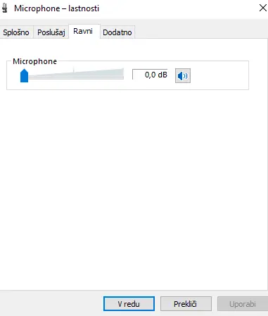

So I thought maybe it works somewhere else, but it also doesn't. Then I checked windows settings and sure enough, the microphone is muted.....but I cannot move the slider, it's like the microphone isn't there, yet the system registers it as an input.

Maybe you have to select the zoom as an input device.
What options do you get when you click on the down arrow where you see "microphone (HS)" in your fist pic?
'Mic' in the windows settings would be the mic input of the computer. It's muted because you are not using that input.

gecko zzed the zoom is selected as an input device, as seen in the first picture. The options i have there are the H5 that is selected and the microphone array (the built in mic in the computer)
mjbphotos the mic im showing is the zoom mic. Windows registers it as an input device and in that picture im browsing properties of the zoom device. It is enabled.

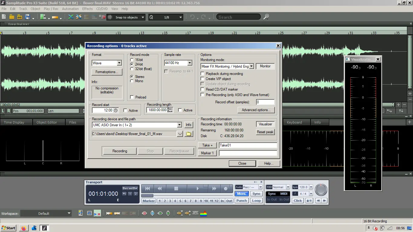

Attached is how my Behringer 204 HD appears in Samplitude for recording inputs 1 and 2. Do you have a similar setting in FL Studio?

ecc83 I have those same settings yes, but it doesn't work in any DAW.
