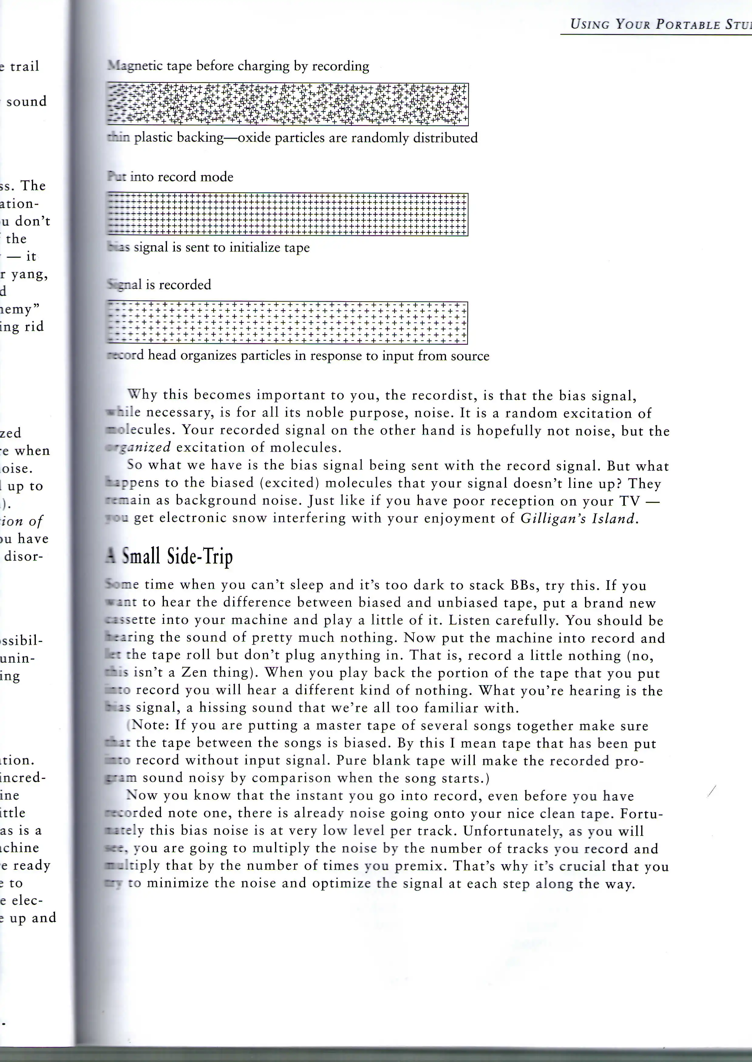

I think the attached image is what got me started thinking about all this in the first place.
And why then does running a tape at higher speed increase fidelity if not for the fact that more oxide is being used to represent the same signal?

The hole in that idea is that particles will always be the same size, but it's still an interesting thought.
I suppose we (I) would have to understand how they are arranged and what exactly that represents.
I think those from the digital age have a tendency to picture digital waveforms which would certainly suffer as a result of being represented by fewer samples.
The difference there is that the samples are longer, where as particles on tape are just spaced out.
Maybe it doesn't make any difference?
