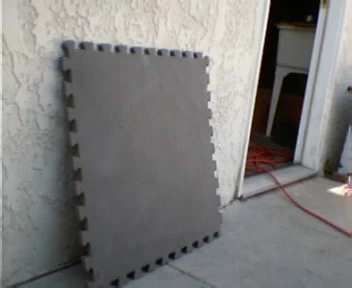

Here's something you might have laying around. I bought it at the Home Depot but you can get it at many other places as well.
