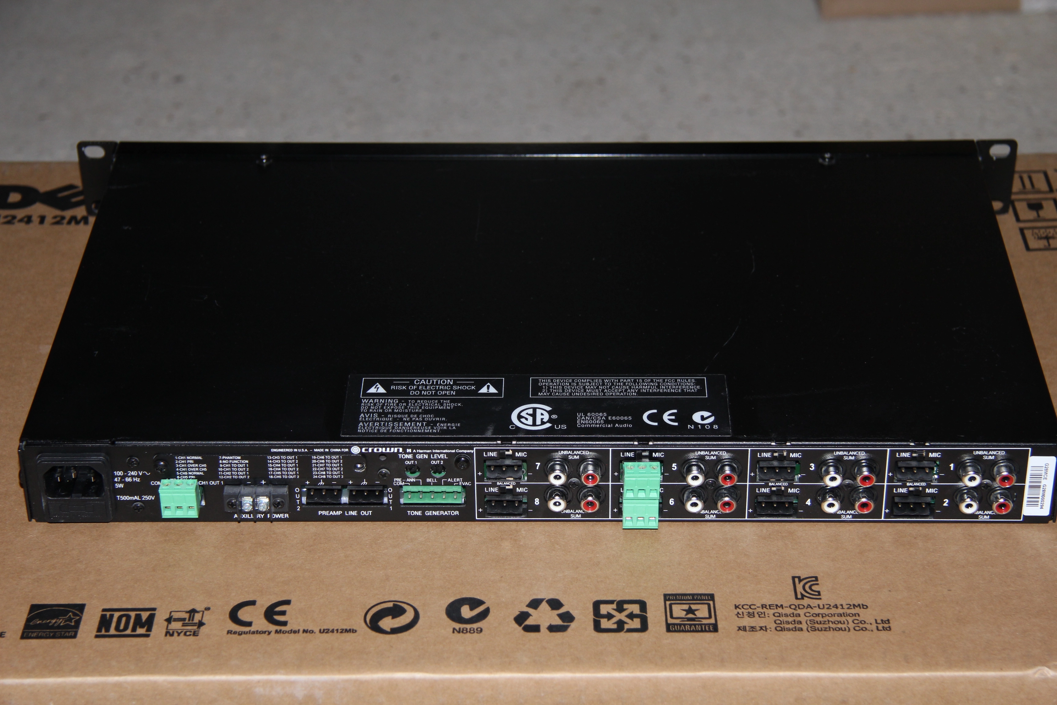

Hi everyone I am very new to the audio world.
How can I hook up a computer to a crown 28m to record whats being said into the mics.
Can I use the preamp output?
If so do I just cut one end off a 3.5 male to male audio cable and plug one into computer and one into pre amp?
Ive been told I can do this.
If this is true does anyone know the color code for how I connect the wires into the pre amp?
Thx much.

The premp out put on the mixer is a phoenix 3 prong. If i cut the audio cable do I run red left. bare copper in middle and white wire on the right?

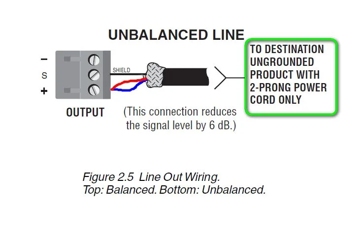

If you're going to try going straight into the computer, try wiring it up like the edited image below. The shield would be the sleeve of the 1/8" plug, blue the ring, and red the tip (or whatever respective colors may be in the 1/8" cable). Wired this way the unbalanced mono signal goes to both left and right in the Line in jack on the computer. As Steen mentioned it looks as if the preamp could be setup in a 2 channel stereo mode where each input channel could be assigned full left or right (note: the left and right ins on the RCA's are summed to mono). If this is something you'd want to the red wire would go to +OUT1 and the blue to +OUT2.
What are you using for mics that get into the preamp with Phoenix connectors?
The message in the green box I believe pertains to avoiding a ground loop between the preamp and the device you're connecting to which may cause hum.

You're connecting a balanced output to an unbalanced input. This should help:
Sound System Interconnection
Note that the three conductors on the 1/8" (3.5mm) plug are for 2-channel unbalanced signal. The bare wire is the shared ground for both channels and the white/red are left/right.
The three conductors on the Phoenix connector are for single channel balanced operation. The center pin is the ground, the pin on the left is the + and the pin on the right is -. To connect unbalanced to balanced connect the ground to ground and signal to +. Since it's two channels the shared ground on the cable will need to go to the grounds on both Crown outputs, the red to the + of one output and the white to the + of the other.

Get a proper audio interface (probably USB), wire up a Phoenix-TRS cable (tip to +, ring to -, sleeve to shield) and connect it to a line input on the interface.
Correct. The first preamp output goes to I believe the Amp. The second is just empty.
