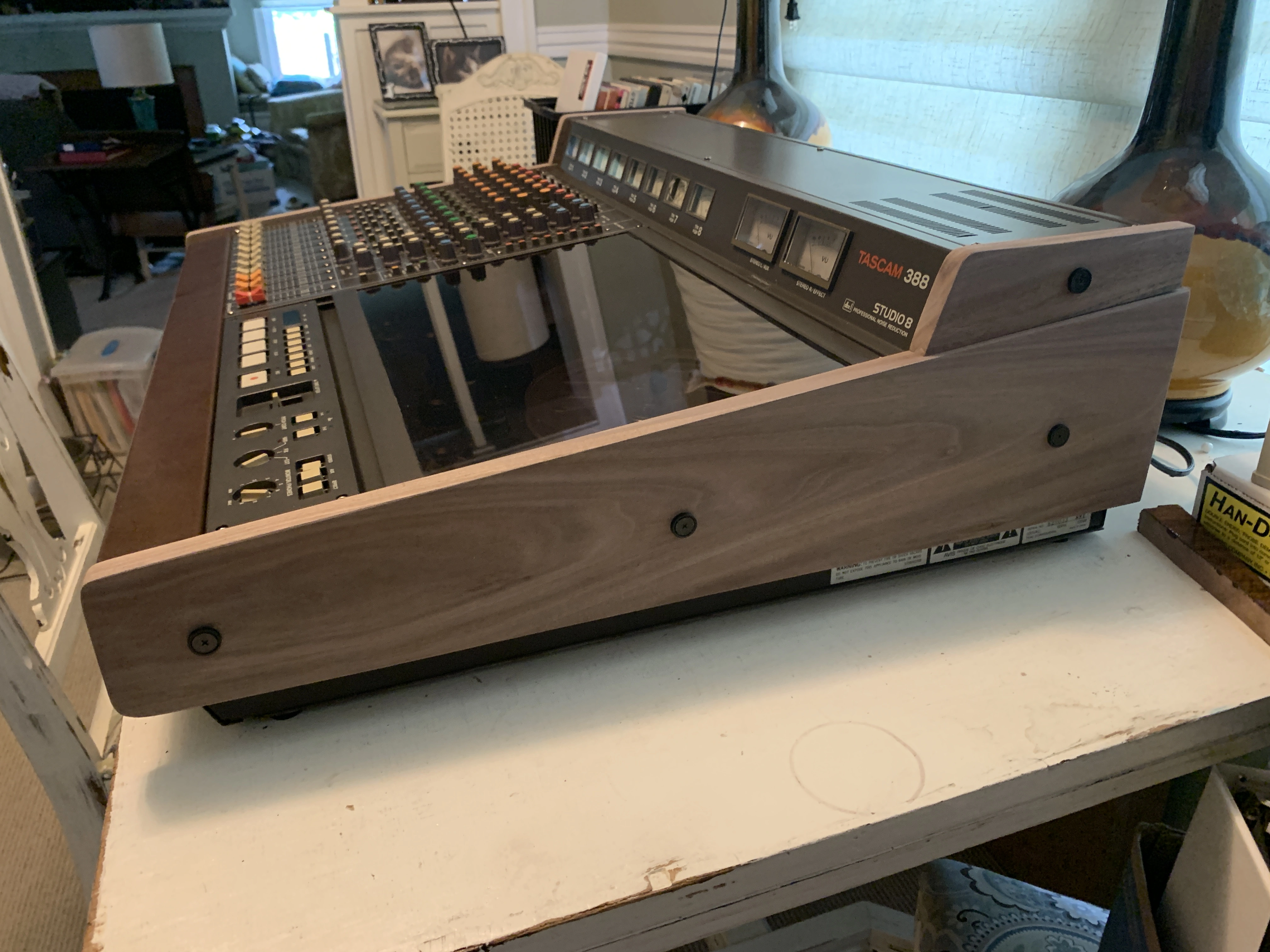

I just made some new wood sides out of some black walnut sourced from our property today. Took a while to let the wood cure since I didn’t have a kiln but I had some old stock on hand. The figuring is nice, can’t wait to get a finish on it. I’m thinking I want something more like an oil finish, not glossy or matte poly. I’ll post pics when I get the finished product. here is the unfinished wood installed for fit. It’s a nice and fitting upgrade for such a grand old lady! I love my Tascam 388!

Yeah that looks really nice!

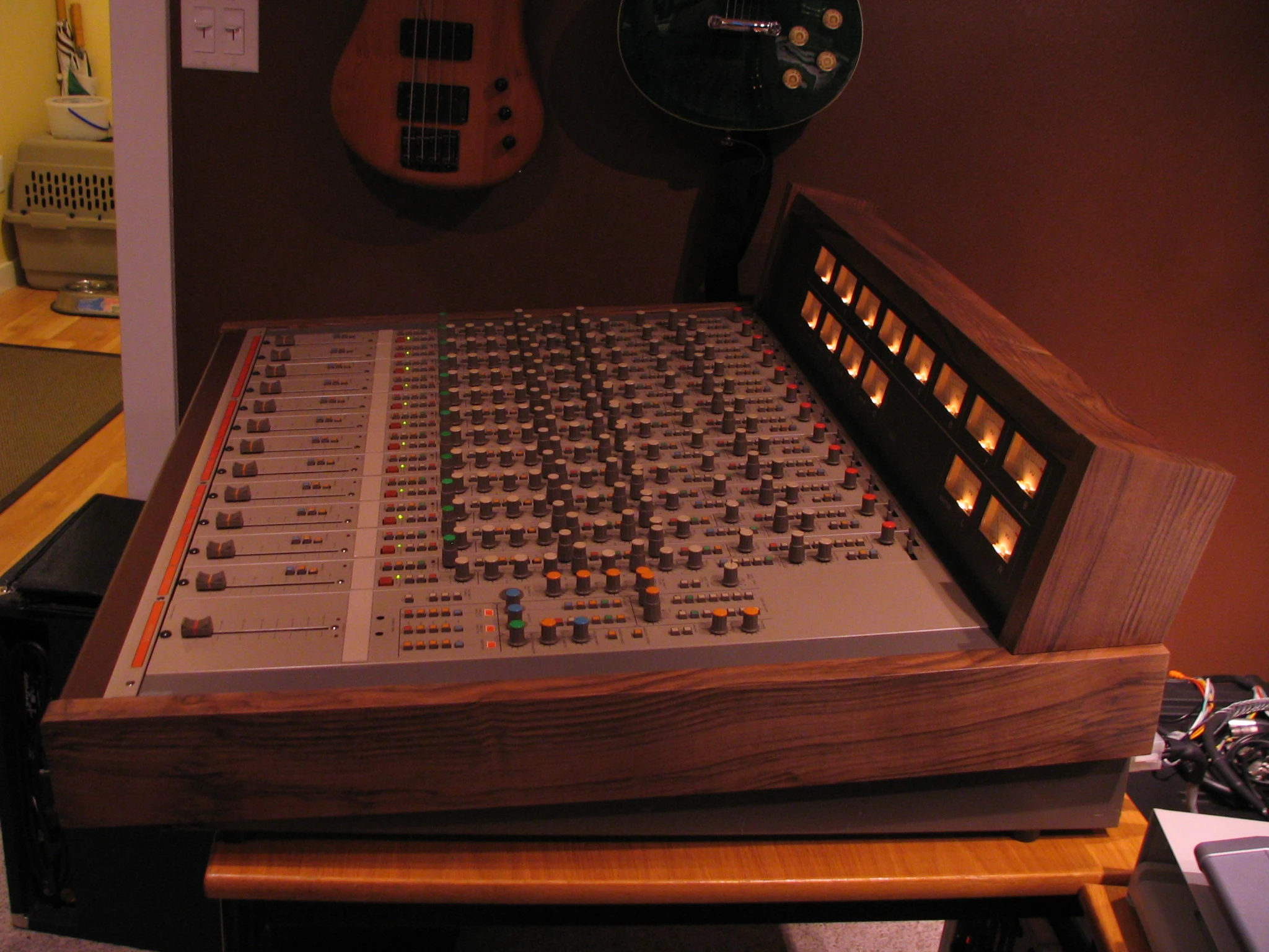

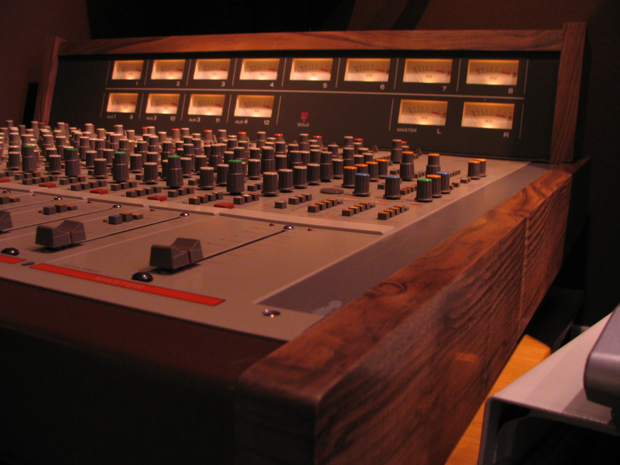

I did the same thing with my early 80s Tascam prototype console…we had to fell a hybrid English/black walnut tree on our property that had recently died. I hauled the logs to a small local mill…made rough cut boards that were kiln dried and then I had a buddy with an awesome 12” planar and a really nice table saw. I used a wipe on poly finish, sanded down to 2000 grit and then 000 steel wool.A5789C83-10BF-4403-B8AE-C4BB6F2C03AE.jpeg
the grain on your wood looks super clear. Looks really nice…

Beautiful work, Cory! I love it.

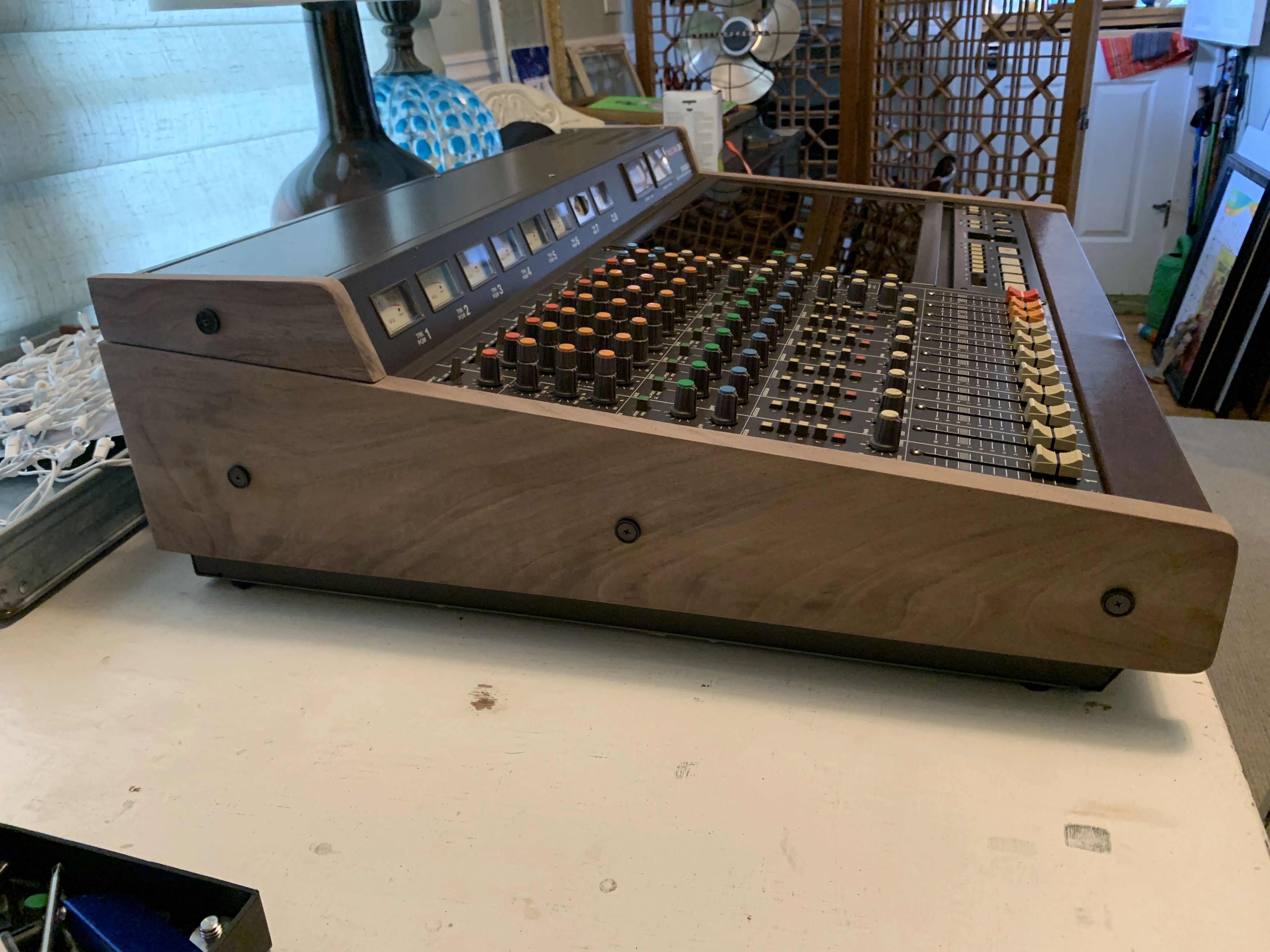

@flyingace what did you use to cut the pieces? You used the originals as templates? The meter bridge caps would be a challenge I’m thinking with the curves. I’ve been staring at it more…looks really nice. Yeah I’ve used a lot of tung oil for custom drums I’ve made, solid body guitar refinishes, etc. but I switched to using a wipe on poly for the quick dry and the ability to define the gloss. I like both, but I wanted a little more shine on my console than I can get with the oil.

Sweetbeats, yes, I used the originals as the templates. Originally, I just outlined the originals and cut them close with a circular track saw, then used a belt sander to “carve” them. it worked great for the small pieces and I was able to create them easily but for the bigger pieces, I actually screwed the old to the new wood, cut close with the track saw, then used a router to trim them exact to the originals. Then I used the belt sander to get them evened out, then palm sander, then hand sanding down to 220. They are all ready for a wipe on poly finish. I was going to use a catalyzed finish like Rubio Monocoat, but I really think the easiest is to use a wipe on poly and finish with 2000 then 0000 steel wool. I have all the original pieces and might start using them, if more walnut presents itself, to make some more and sell them online. We’ll see. Probably not a lot of people willing to pay for that much work!
