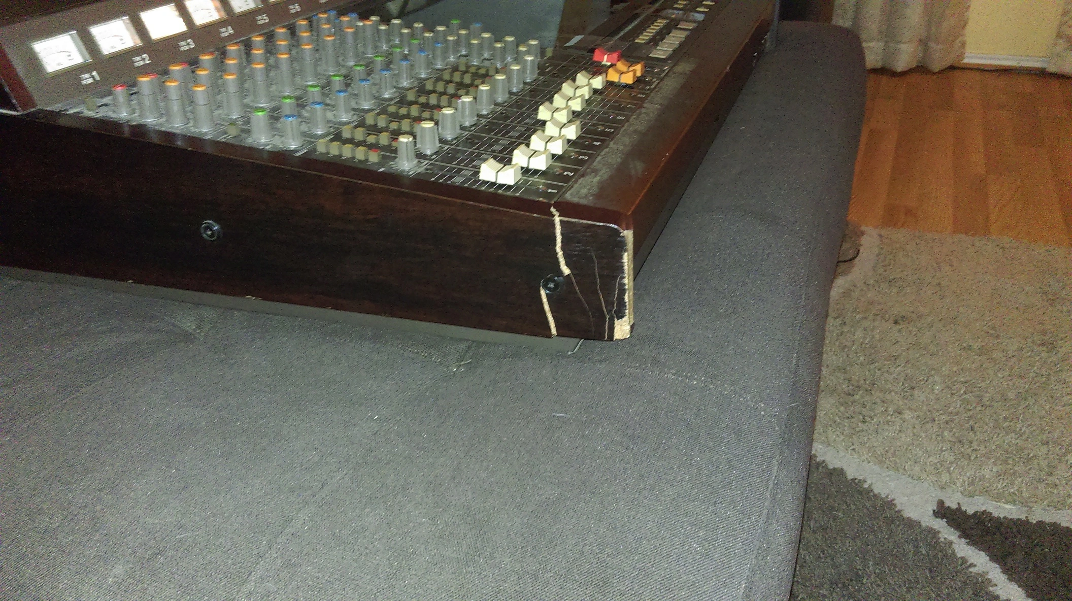

The bad news: it obviously took a fall at some point because one of the side panels is broken right near the front. The chassis has been bent a bit because of this. That's not a huge deal because I already have a nice piece of wood that will be perfect for making new panels. And I'm pretty sure I can bend back the chassis close to the way it was.

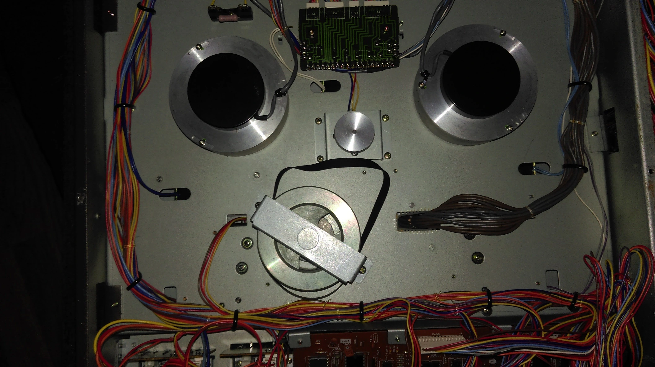

I fired it up when I got home, and all of the VU lamps work, as do all of the lights, which was great. However, the transport was totally dead. When I opened up the back, it was just as I'd hoped/expected: the belt was stretched out and had fallen off the capstan drive. So I have a new one on the way now.

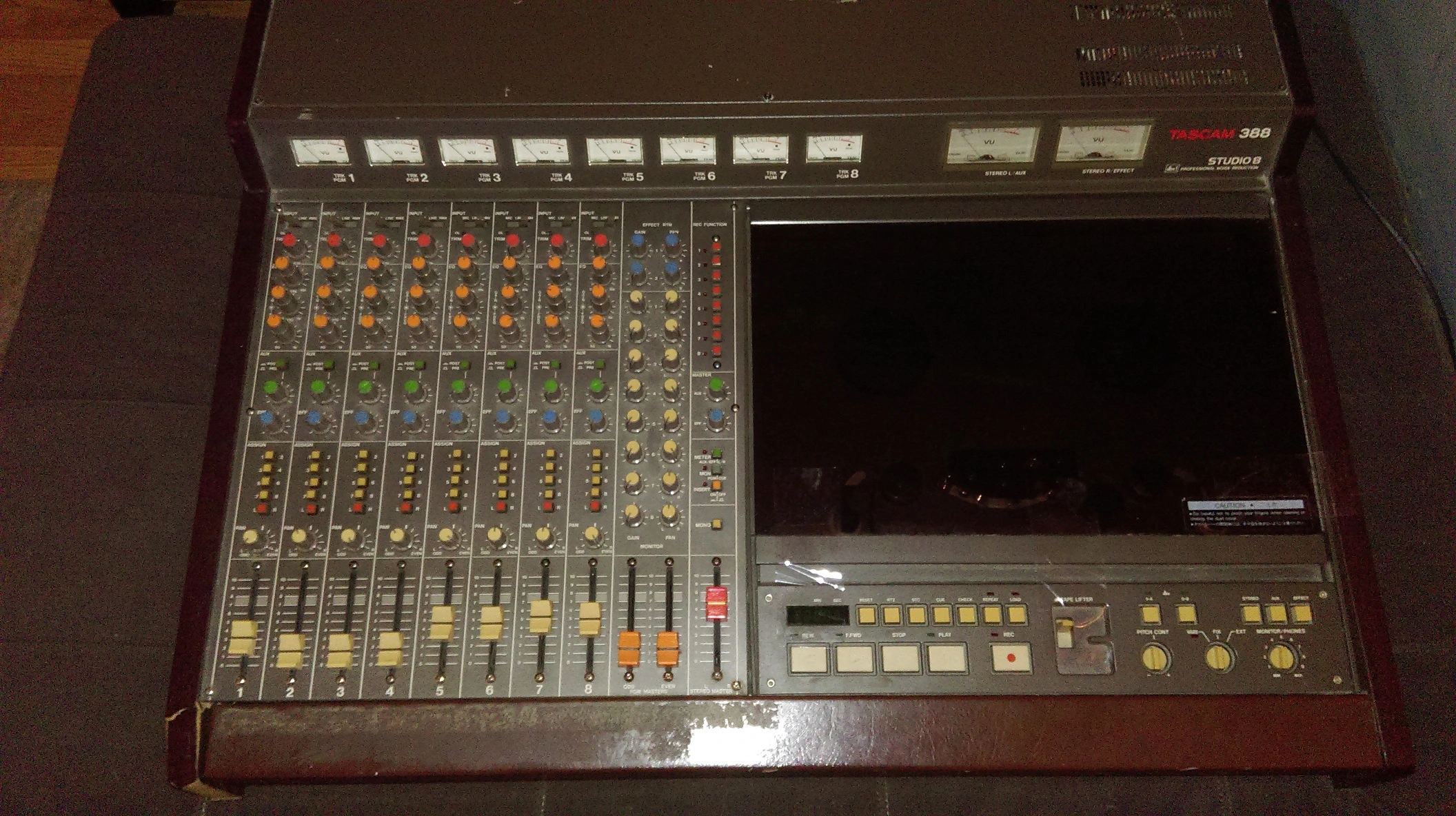

This weekend perhaps I'll find the time to run signal through it and test the mixer and inputs/outputs/etc. Ted (my friend) told me that everything worked when he last used it, but he admits that he probably hadn't turned it on in over 10 years. That gives me some hope that perhaps a new belt will put it back in commission.
The pictures show how it looked when I got it home. It already looks a lot better after I cleaned it up (all that tape residue on the arm rest is gone, the chassis and knobs/faders are clean, etc.). I'll post pictures again when I get the new side panels installed. Also, the heads look to be in very good condition, which is good news.

Not trying to be negative...but I would do some test/comparison recordings and then decide.
That 388 looks kinda beat up to me in the pictures...so no telling how well it will operate...but maybe it's all just cosmetic.

You can't go wrong with a free 388. Even if it is a little beat. Keep em both! My spare 388 resides under my bed.
Be sure to change the fuses and oil the tension arm rollers. Re-seat the cards and hope for the best. If it is shot, part it out. I'd be glad to by some spare parts.

I think I still have a set of spare 388 side panels in decent shape.
