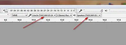

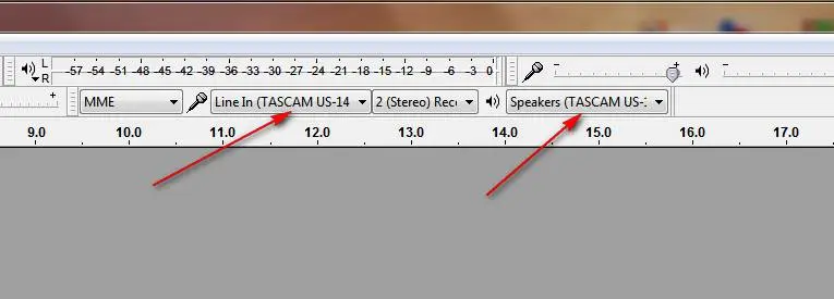

- Audacity has the Alpha selected for input? Below is for Tascam, but should be something interface relate.

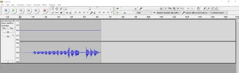

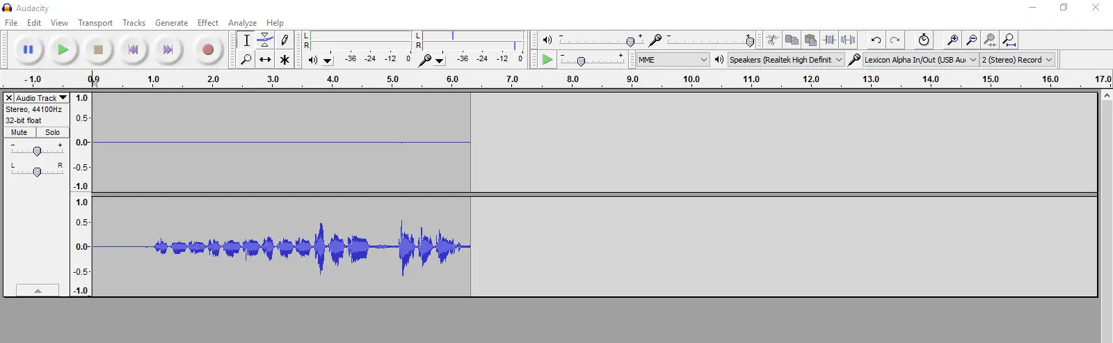

Now, the only issue I am still seeing is that it is only recording the right channel in Audacity. It looks like Audacity is set to stereo, but i'm only getting signal on the right channel.

"Now, the only issue I am still seeing is that it is only recording the right channel in Audacity. It looks like Audacity is set to stereo, but i'm only getting signal on the right channel."
That is how things should be. Audacity is recording two channels (well, a stereo pair) but you are only sending in ONE mic signal. This a feature (drawback? problem?) of almost all Audio Interfaces because they rarely have an INPUT mono'ing button nor a "pan" control, you would have the latter on a mixer for example.
Solution? XLR to 2x XLR splitter or you might be able to pan the recorded signal to both tracks in Audacity, don't use it enough to know.

'Now, the only issue I am still seeing is that it is only recording the right channel in Audacity. It looks like Audacity is set to stereo, but i'm only getting signal on the right channel.'
Set Audacity to record 'MONO' (between where you set the interface selection). You won't have a stereo audio tracks, but it will/should playback from both left and right sides. You can use the pan slider to move the audio left of right.
"Set Audacity to record 'MONO' (between where you set the interface selection). You won't have a stereo audio tracks, but it will/should playback from both left and right sides. You can use the pan slider to move the audio left of right."
