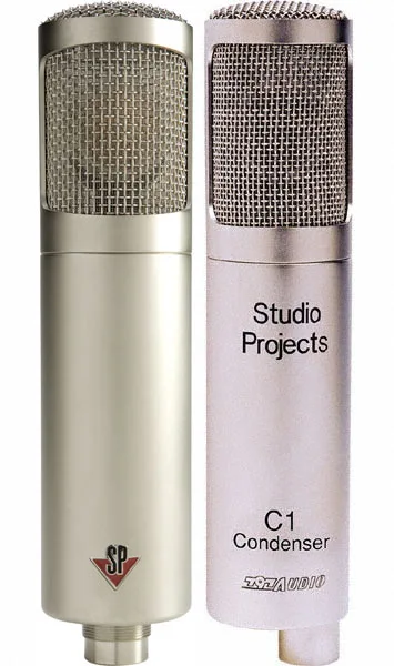

New and old, for those who don't like to click links.
Wow, lots of questions, and I am happy to answer them. First of all, let me list what the changes are;
1. Higher Polarity Voltage to the capsule: Lowers noise floor by 10dB
2. New frequency tension on capsule: Smoother response in the low end
3. Updates to components using higher quality polystyrene components
4. Lower resonance body: Less artifacts from reflections
5. New Head grill design: More air over capsule for better sound
6. Stronger reinforced mesh over capsule: Prevents damage from accidents
7. New SP Halo Shockmount: A better, more flexible shockmount system that allows multiple mics to be mounted from a single source point
8. Higher output: More gain to the mic amp.
Now, to us, this has been a good amount of upgrades, but it is still in the budget range of dollars, so we are not making general comparisons to anything. We just like the new sound and performance better.
The new Halo Shock mount system will be available for other microphone brands that use a threaded mount. This new shockmount designed by us is not cheap at $189.99, but is included in the C1, C3, and T3. So yes, we have raised the price, but you get much more, and all models are RoHS and WEEE compliant.
Not looking to start a fight here, but Chessrock mentioned the Scott Dorsey mod. No, we do not use his mod because his mod is not very good and flawed. There is no adjustment for the bias to the voltage for the rails on his mod, specifically his old mod that was going around these boards. We do not put much into that mod, but others seem to pass it around. Scott is not a mic designer and should know this mod has issues. I hope this does not start a rampage, but it had to be said and it is "our or my opinion".
