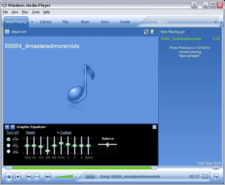

Just playing this thing in my windows media player and using the horrible eq that it has, I cut out some 250 hz and boosted a little 1000 hz and the guitars got way clearer. There's a good starting point!
Is this with the V-Amp? When you layer your tracks, you might try doing two of the tracks with a different sound if you're not doing that already. Maybe a brighter sound with the low end turned down quite a bit. Two tracks for definition and two tracks for heaviness.
Here's a screenshot of the EQ settings I was using in windows media player. I know...it's not exactly scientific, but it's a good place to start.

All the version I have posted all has some sort of EQ on the entire mix along with compression. I looked at what you had from the screen shot below and ajusted acordingly.
