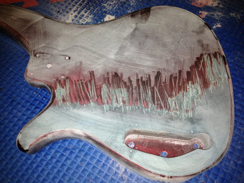

I had a similar situation with my first P. We stripped the old paint off, and sprayed on new (actually my dad did it at the body shop and I just watched). But the whole process took only two days with heat/putty knife, then orbital sander and lots of hand sanding (I got to do a lot of that part) on the first day and then sealant, undercoat, color, and then a generous allotment of clear coats (I think 6) on the second. Two days after the work, we started assembly (dry time from 10 coats of enamel). Got it together and the sound was simply not great. But we tweaked the electronics (DiMarzio pickups and a slightly bigger cap on the tone control) it sounded brighter, but still had sustain issues. We machined down an International combine shear pin to make a brass nut, and everything came together. Lots of tweaking with height adjustments and etc. etc. etc. and we had a beautiful bass that I played for 15 years.
