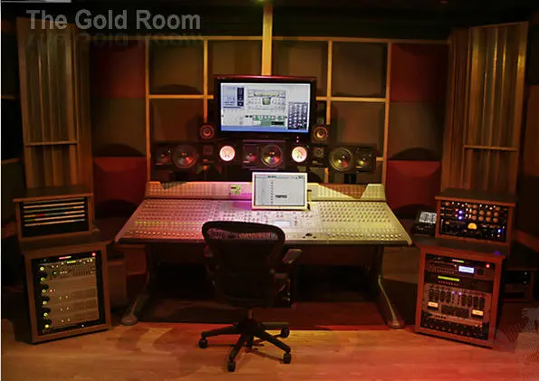

What do yo u guys think about these?
http://www.advancedacoustics-uk.com/Problem_Solved/Tegular_Acoustic_Tiles.html
I was think of buying the 4" option and using them for bass traps on the larger bare walls in my room. In front of my desk and behind my desk. To give it a bit of a classy look as well as doing it's job. Much like this studio.
