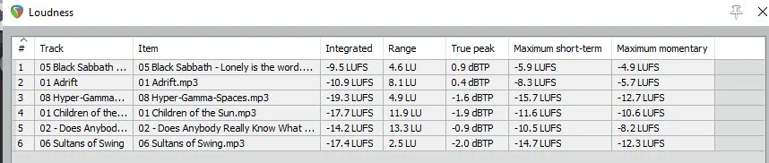

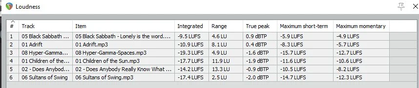

You're sorely mistaken if you think that is the norm. I just pulled a half dozen commercial recordings into Reaper and measured the LUFS for each track. NOT A SINGLE ONE hit -6. Here are the statistics.
If all you measure is thrash metal, where everything is just a barrage of sound and the needle never moves below -2, then yeah, -5 might be there, but that's more the exception for a specific genre. You're squeezing all the life out of stuff.

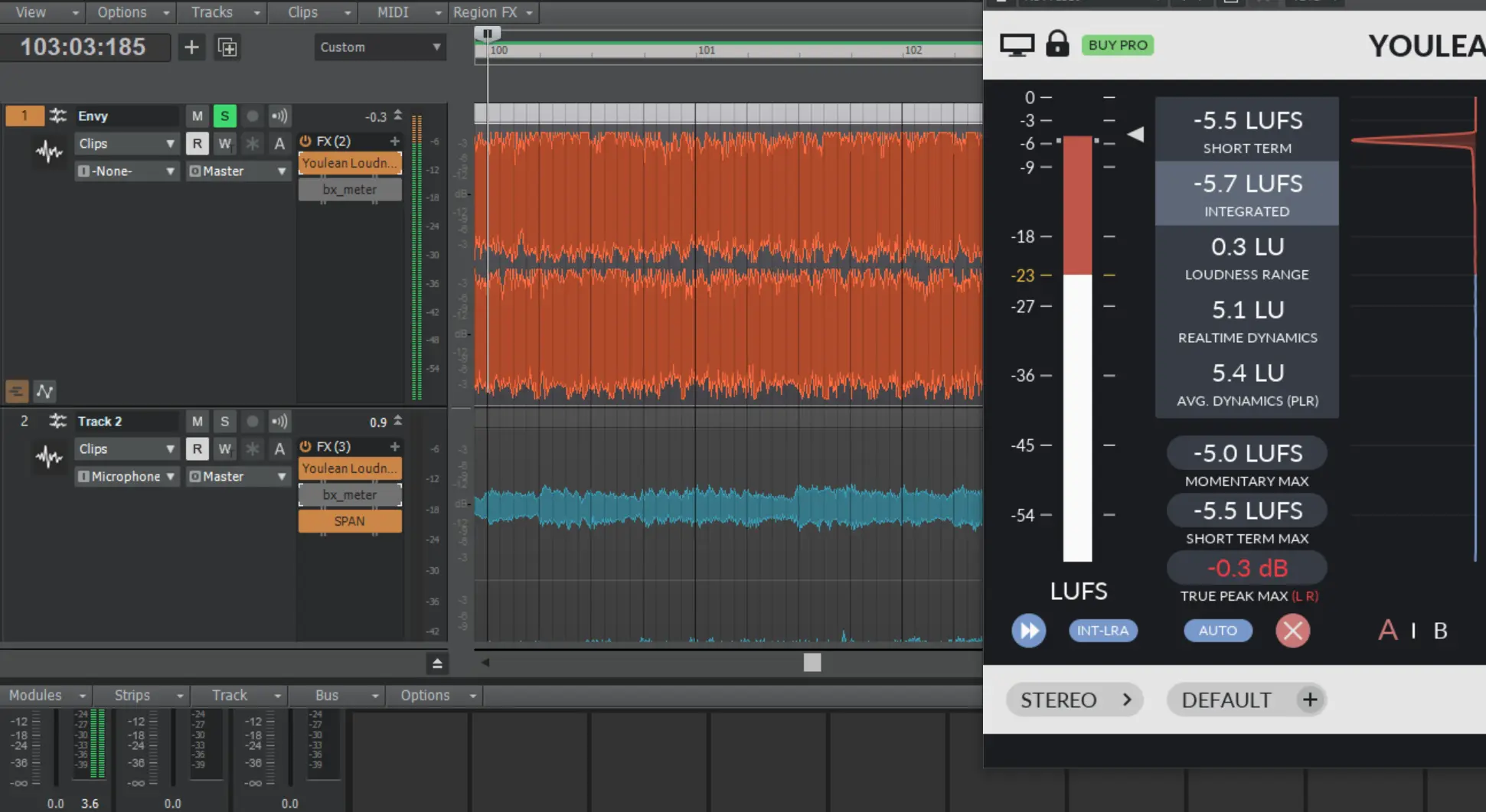

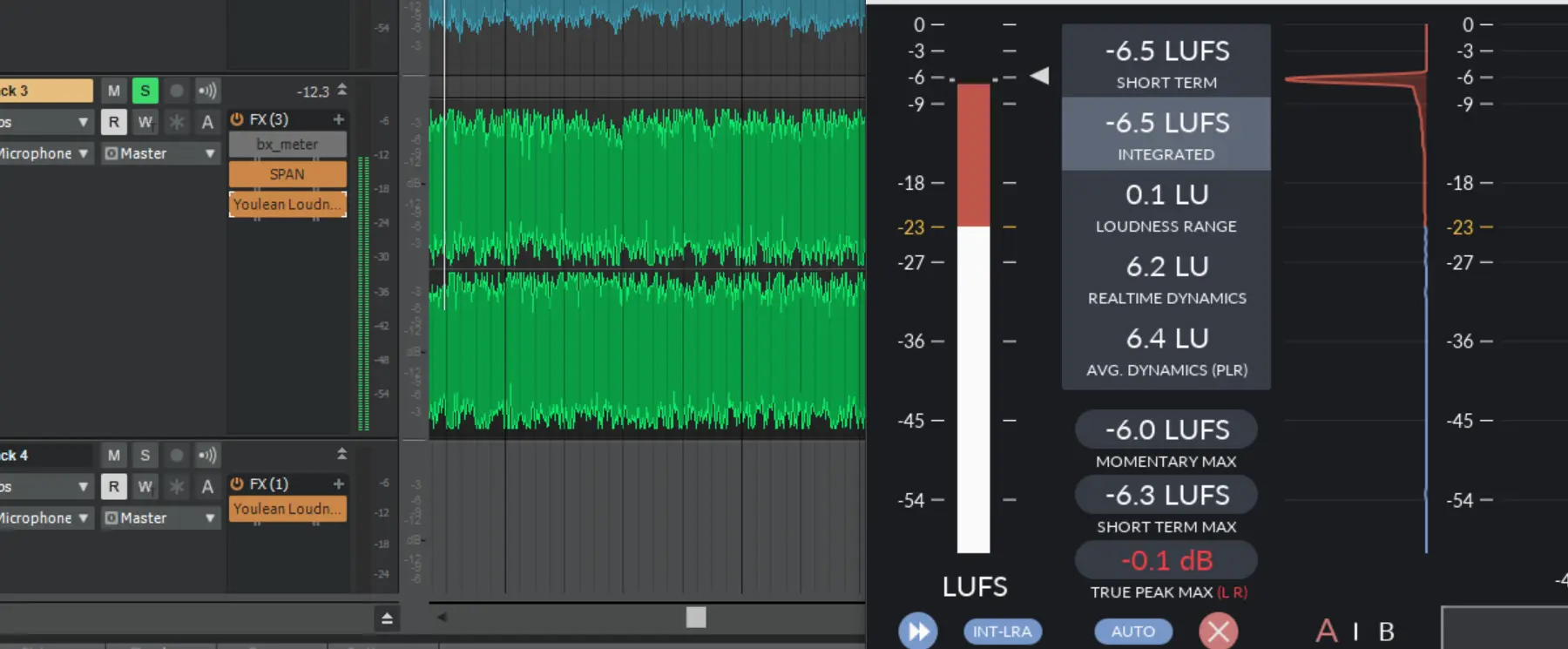

Not really like my references pal, just see.
Where have you downloaded those references? might be the format? Mine are in FLAC downloaded from soulseek, yours?
MOGWAI
ENVY
Yeah, Beakster, the SWS extensions are really great. I've got Ozone Elements, but so far, I really haven't used it for much. I really didn't like the way the presets sounded. The add on I really use is the Bricasti M7 reverb IRs. They work great with ReaVERB.
I'm measuring only the explosive part of the song, the highest in volume, not the quiet parts eh

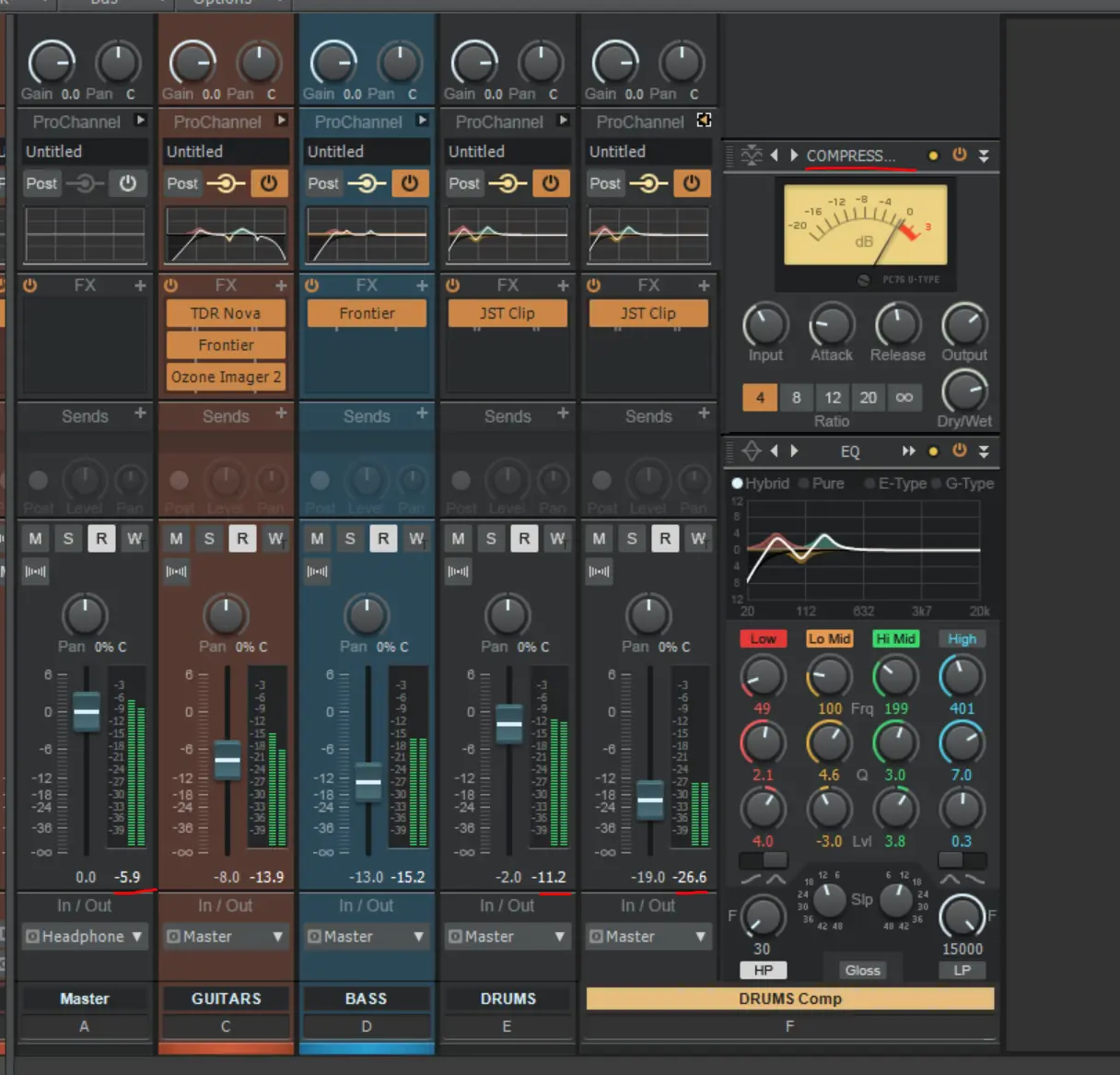

I used parallel compression and saturation on drums, this is the situation in my mix busses, does anything look abnormal to you? as you can see I didn't push the compressor that much, the peaks are those -6.5 dbs in Master bus, -14.0 guitars bus etc.
