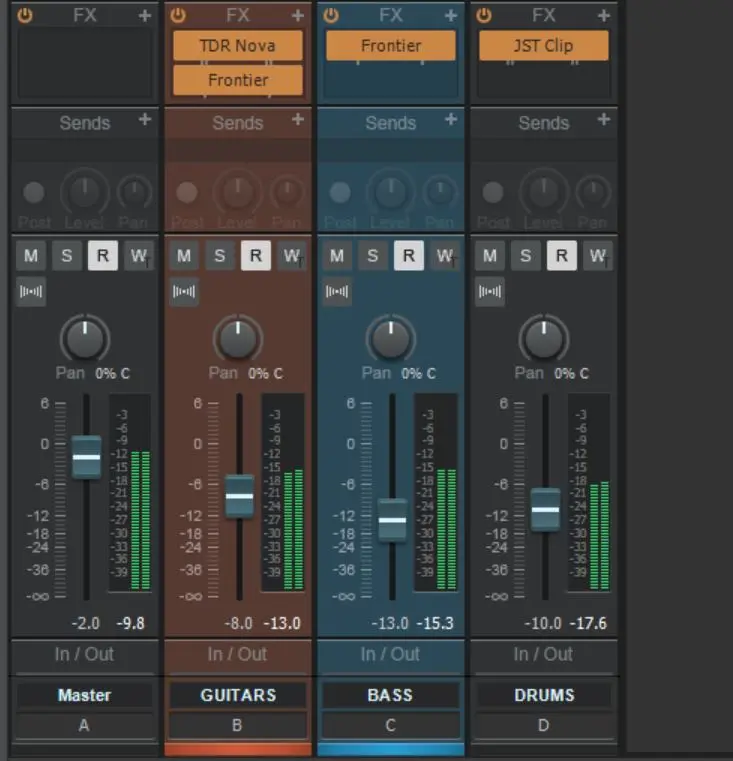

So below you can see the situation on my Mix busses, as you can see I have nothing on my master bus, but I have place a clipper on my drums bus just enough not to distort, and also an extra one on the drums track to load balance, also I put a compressor and a saturation knob on my drums bus.
On the guitars and bass bus I placed a limiter, also some limiters on single tracks that were having too many DBs, I used the limiter carefully.

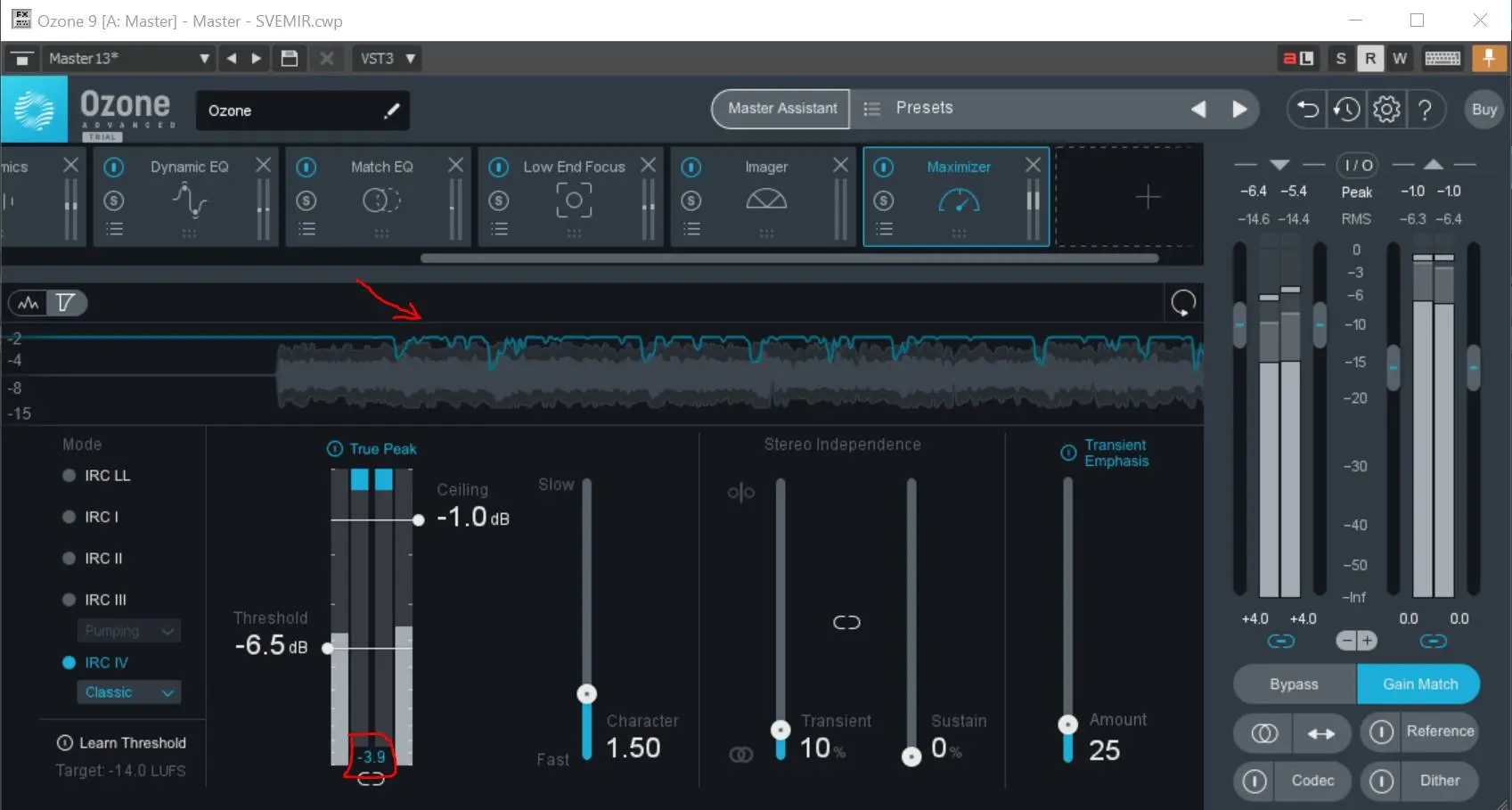

Despite this my MASTER limiter (see Ozone following photo) is still going a bit crazy over the drums transients if I try to push it at -7 or -8 dbs in order to stay at around -7/-6 LUFS on the loudest part of the song.

What can I do still to raise my track volume without causing this kind of crazy gain reduction on my Ozone Master Limiter?

MASTER LIMITER

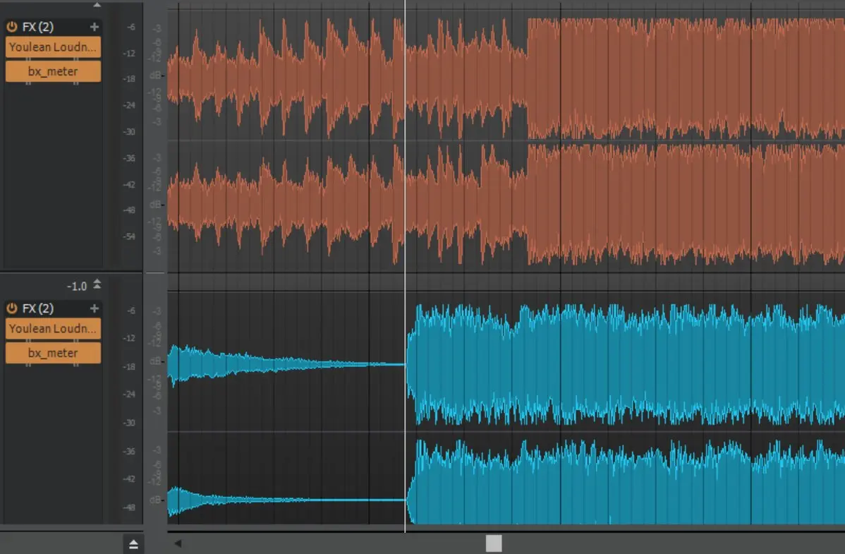

Analyzing my master (below) with my Reference Track (up, downloaded in FLAC from internet) I can see mine is more dynamic, so I suppose I can still push with the limiter despite the gain reduction that I see in Ozone? Please don't say trust your ears cause I'm newbie on this.
