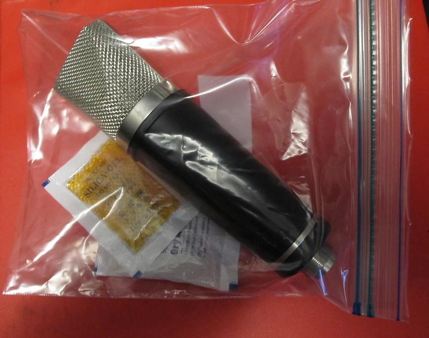

Condenser microphones are sensitive to moisture on the capsules and may work partially with static sounding noise or may only have noise. Are you in a region or room where the air is humid/damp? If you think the mic may have been exposed to dampness, place the mic in a plastic ziplock bag with some desiccant packets for a day or two as in the image below. The desiccant will draw any moisture out of the mic.

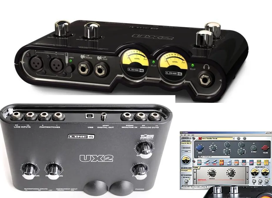

The Mic w/ Phantom and the Line 6 software should work fine. Its a USB powered mic preamp thats really weak on its own but you should hear something, especially with a LDC. Measure the Phantom VDC?
Might try another Microphone....have any SM58's laying around? this would exclude needing the phantom power, but you might have to crank the preamp to 100%
