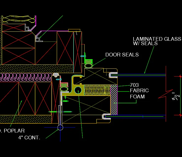

And btw, how far into the rabbit hole do you want to go? Here is a detail for a vocal booth door. Try to build this Mr Brilliant.:rolleyes: Or even square cut a simple panel of 3/4" MDF @ 3lbs sq. ft and haul it into an apartment and the n FASTEN 6 panels to the outside of the so called "wardrobe" so every joint is
airproof, not to mention the door.
good luck.

That diagram just gave me a seizure...
Is it a time machine? :confused:
