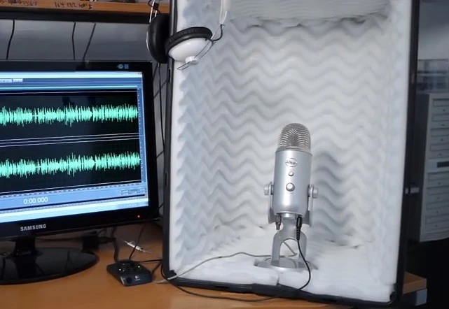

And after testing the mic out when I first got it and thinking the audio quality was a tad lacklustre I built a small sound booth for recording. Like the one in this picture:
But even now the vocals come in either incredibly tinny and sharp without the booth, or muffled with it.

I could offer advice, but anything I say will involve getting rid of the ice-chest "booth"...getting rid of that mic...getting rid of the whole USB approach....getting something that resembles a decent mic/pre combination....getting the mic away from the computer and out in a better environment....and then finally, focusing on your singing technique....

Also get rid of that mic booth. As you said before it is going to muffle the sound. Ultimately you are going to want some proper acoustic treatment but putting blankets close to the source of flutter echoes can reduce some of the tinniness you are referring to without breaking the bank.

I agree with JG. A dynamic mic is your best bet without room treatment. Anything is better than that 'booth' thing you have. That is actually creating more issues with reflections. You are in essence creating an even smaller space for the mic. The foam is not absorbing all of the reflections. You may as well stand in front of a wall...
At the very least get just off the center of your room and hang some blankets or better pink insulation forming a 'V' behind your mic. Then something similar behind you. The purpose of this is not to attenuate sound leaving your throat behind the mic. It is the reflections coming back to the mic after it hits the walls. This is why your 'booth' thingy is not working. Throw it away.

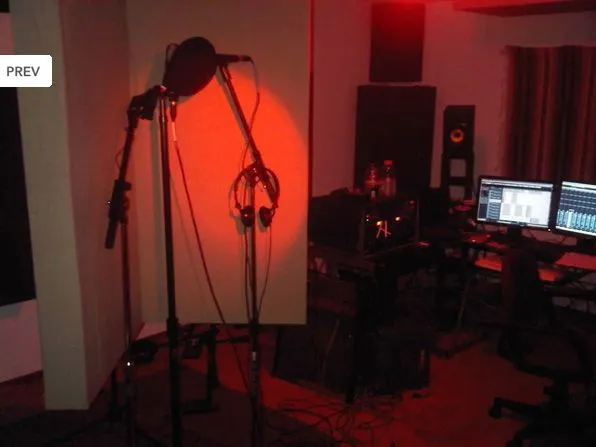

Here is what I use. Hanging rockwool panels in a treated room.
Wow, that is an old pic. What the hell is up with that wall blanket? lol
Actually I have a spot light with a red gel that singers seem to enjoy. Whatever...

I've already converted my 'booth' thing into a large 'V' shaped object to go behind the mic. I'll also definitely be giving back this mic back to my friend and invest in a new one. God knows how he records anything with it.
