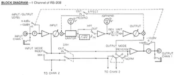

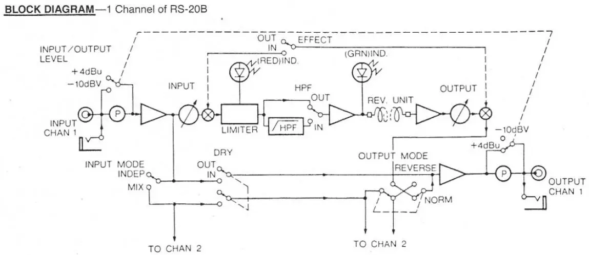

To fill in some of the blanks I've attached a jpeg of the block diagram below. I have a feeling that the 2041 handles the input and output stages of the channel while the 6552 IC's handle the input and output stages specific to the springs since there are actually two springs for each channel; four springs total in the unit.

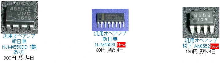

Sometimes google image search may be a help to find some clues about a mystery component.
