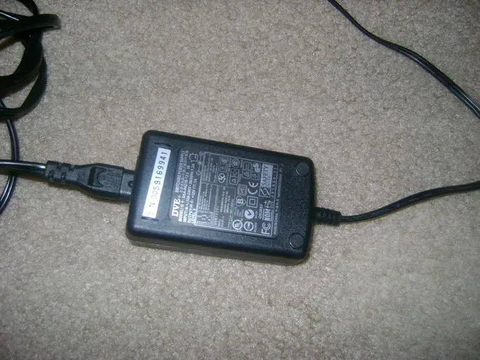

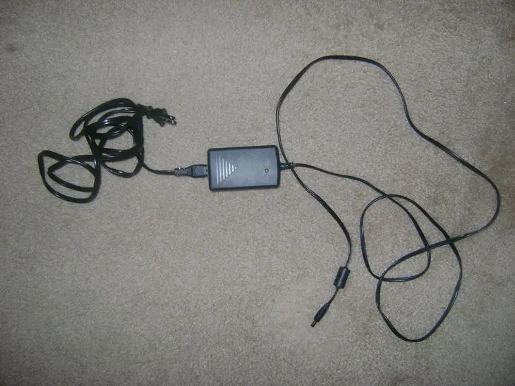

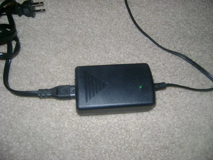

Do I have the Correct Power Supply? Probably The Seller Sent me The Wrong One.

Here is the replacement one. It does not look like yours. This one is 12 volts AC output. What does the one you have say?

Yeah, the one on The website looks totaly Different this one says: "Swithching" Power Supply and doesn't have the M-Audio Logo.
I hope that i didn't Screw it up Connecting the Wrong Power Supply.I want to put it in a repair center but i want to make sure that I don't have the Worng PS.

Can you post what the output of the power supply says? Is it 12 volts AC or DC? Also what does it say about the amps? I think I see 3 amps but I could be wrong.

INPUT:100=240V~50/60Hz 1.2A
Outuput:+12v 3a
I think he sent you a laptop power supply, that's what it looks like. I can just make out a DC graphic. So you have a 12 VDC instead of a 12 VAC supply.
I would go to radio shack and see if you can pick up a 12 volt AC one with 3 amps.
It is an AC
Well if it's an AC output that's correct. You will have to troubleshoot further to see if the problem is with the adapter or the Tampa. I would get my hands on a multi-meter and see if the adapter is putting out 12 AC.
As I stated before, contact the seller and do this first. Make him aware of the wrong power supply and that it may possibly have damaged the Tampa. Be sure to document any correspondence you have with him in the event there is a problem. Buying an adapter may work, but if the Tampa has something fried due to the wrong voltage, you might be out the cost of the adapter.

Even looking at the adapter you can see the DC (+) and (-) polarity marking on the output connector diagram.
I agree. I think it's 12 VDC. The graphic looks like a dotted line which is DC and AC would have a sine wave graphic.
Putting 12 VDC into the Tampa will not fry it. The Tampa uses a bridge rectifier to change the 12 VAC to DC. Putting 12 VDC into a bridge rectifier does nothing. I have mistakenly done this before. Have you contacted the seller? Maybe he just put the wrong power supply in the box.
