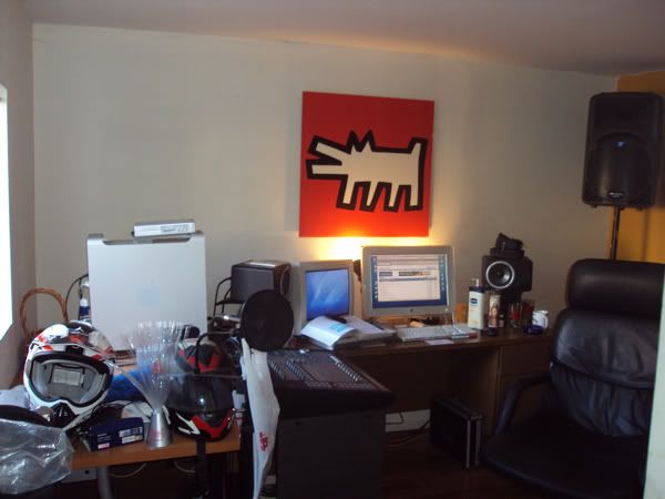

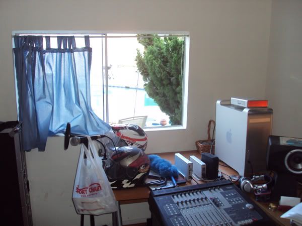

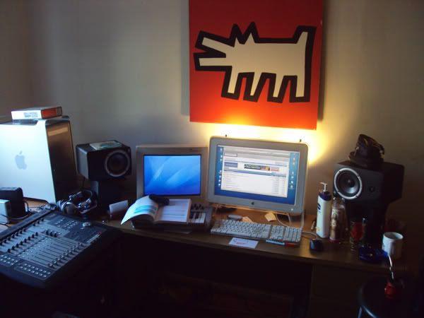

hey guys, Here are some pics of my studio. the room is 11.125 F width (the wall with the picture), 10.75 lenght (the wall with the window or orange wall) and 7.3 height.
I dont have the money to do soundproof but I was thinking whats the best desk placement based on the romm. Also bass traps?
Let me know what do you guys think?
thanks a lot in advance

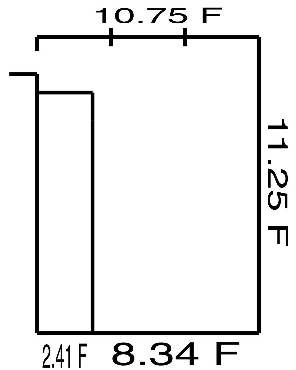

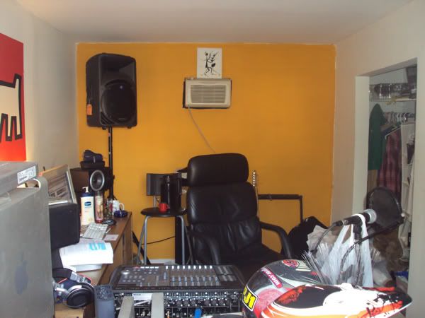

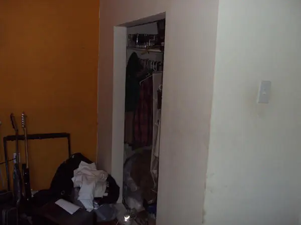

Yeah, as you can see on the orange wall there's a little built in closet which Im planning to take out of the rooom but after some comments in another forum do you think it might be better to keep the closet and close it with a door or something and keep the room as a rectangle?
here's a pic of the closet and also a drawing of the lay out
let me know what you think

That's a small room...I would take out the closet and use the entire space.
I agree. Symmetry is important too.
If you knock down the closet, then it'd probably be best to face the orange wall. You could also install a full-length heavy curtain across the back wall (wall with the window) and bass traps in all possible corners.

Mmmmmm...I dunno....I think facing the window and letting the monitors fire back towards the orange wall is a better idea since he can place some trapping/diffusion on that orange wall....
...plus, you get a nice view out the window during the day as you mix. ;)
Facing the orange wall...the speakers fire into the window, so it will be that much harder to apply trapping/diffusion to a window (unless of course he decided to cover the window).

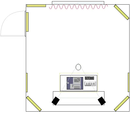

Here's how I'd set up your room after removing the closet.

anyway, yeah...PandaDudes drawing looks about like what I'd do. And remember...ESPECIALLY in small rooms...bass traps are your friend. ;)
hahaah its just moisture conditioning for hands!! hahah
Yeah, I think pandamonk's idea is good. Im gonna take those 2 walls down and face the orange wall.
