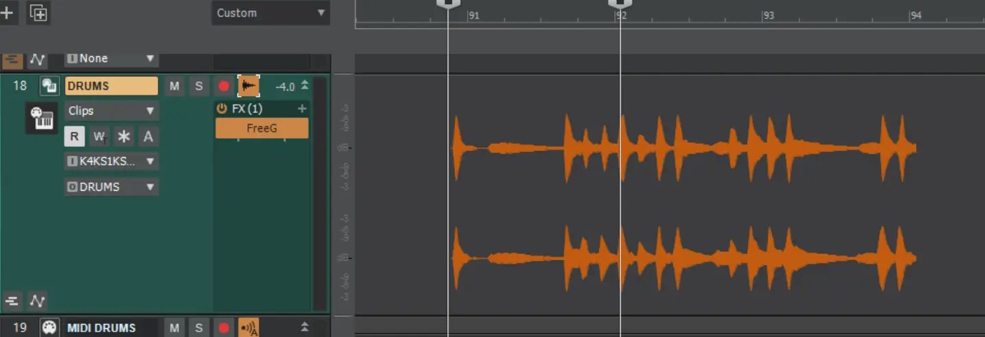

Thanks for the suggestion but I don't know why some of you are insisting that the drums are delayed on the left side, they are not delayed! they are wide ok, but not delayed, and this is the proof, they are perfectly aligned left and right

[EDIT] Wow, there have been some posts going on. Again, visuals prove nothing. You're not zoomed in nearly enough to detect a [several MILLISECONDS] delay at that point anyway. And again - The stereo track on it's own sounded perfectly fine. The track IN THE MIX sounds NOTHING like the stereo track on its own.
