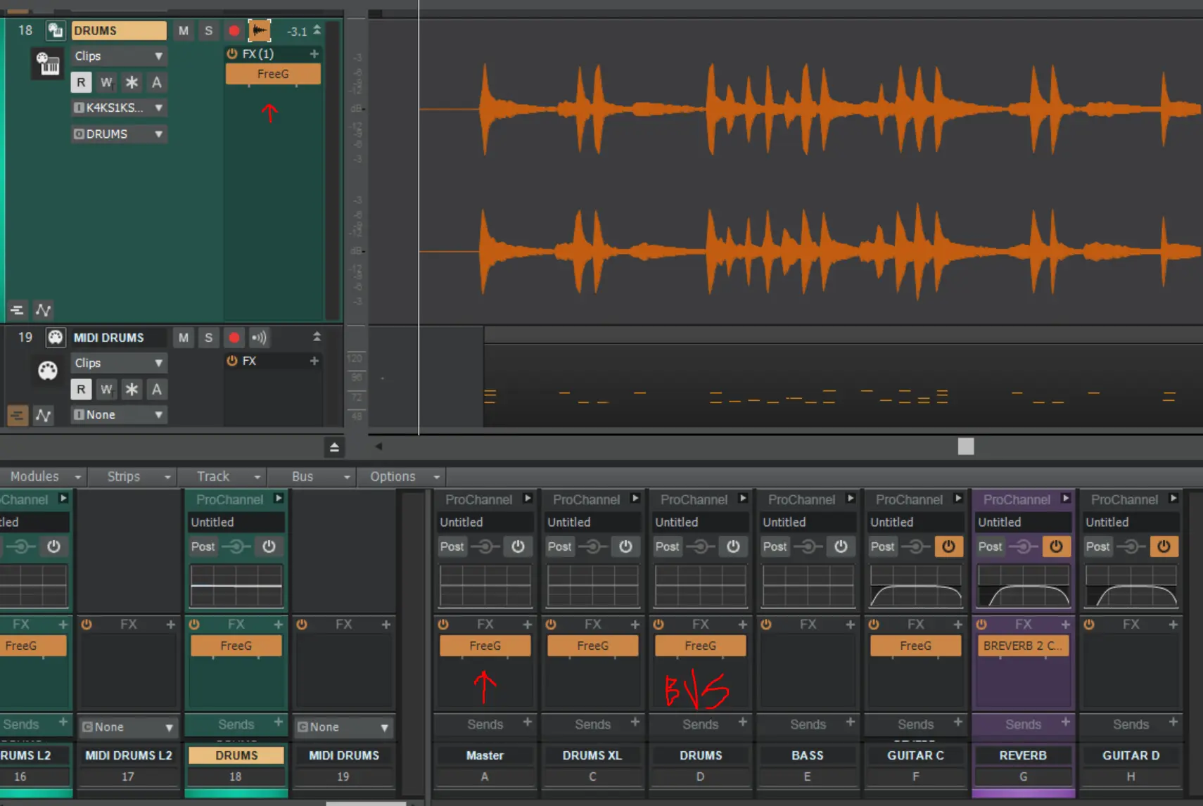

Ok, I get it you mean when the heavy drums part starts?I’m struggling to understand whether you are speaking about an audio / mixing problem or a simple matter of sound taste.
Notice that the distortion I applied in that part on the rithm heavy guitar is a big muff pedal, which makes a very fuzzy distortion. Used mainly in grunge, shoegaze bands. So that is intentional, if you mean that.

Okay - The distortion on on the AI guys. The Haas filter is on you -- You have your drums (all of them, from what I can tell) going through some sort of Haas / delay that's wrecking the phase, especially on the low end. It's something you can get away with on overheads / room mics to some extent (was big in the 80's metal stuff, where you'd delay one of the room mics by 5 or 10ms, or as an auxiliary send that was high-passed in an otherwise unnatural fashion, so as not to mess with the phase in the low end).
The reason I was asking about the original mix was that if the AI's are using something like Ozone, it's one of the few things I know of that actually makes it very easy to throw the phase and time (via the Haas effect) of the low end out of whack. This is one of those "It's your mix and you can do what you like" things - but I'd highly recommend panning the kit however seems natural and if you want to add a slight delay - likely in the form of a short, dense reverb or slap that isn't actually identical to the source audio - you'll wind up with a much more balanced and natural (for lack of a better term) result.
Instead of having "width" you're winding up with *all width* - anchored to nothing. There's *nothing* in the center. Everything is just passing through on the way to the other side.

Bloody hell,
so if I understand correctly, pardon my english, is that there is a HAAS (no idea what that is) filter on the drums, so it's a delay basically.
Honestly I'm not a drummer and not a mixing engeneer, I just made these MIDI programmed drums with a plugin.
I have sent the track also to a friend of mine who runs a recording studio and he's a drummer, to ask for an opinion, he said it sounds great, but I understand friends might not be so critc.
So would you please confirm what you just said by listening only to the drums track here attached? so you can hear it by itself and tell me about this delay, which honestly I don't hear, I increased the room and distant room mics to make it less dry thats true, also cymbals volume seems fine to me, but again, I'm not a drummer.
Here's the track

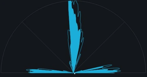

Ooh - Looks like I can add images in line - Visually speaking, here's the drums. Nice core, nice width, collapses to mono very well, very natural sounding. If these are MIDI drums, I'm actually impressed with the realism of the stereo image. And this is pretty much representative of a typical mix. Okay, maybe a little more energy off to the sides with a wall of guitars, and certainly more information along the stereo spread, but there you go.

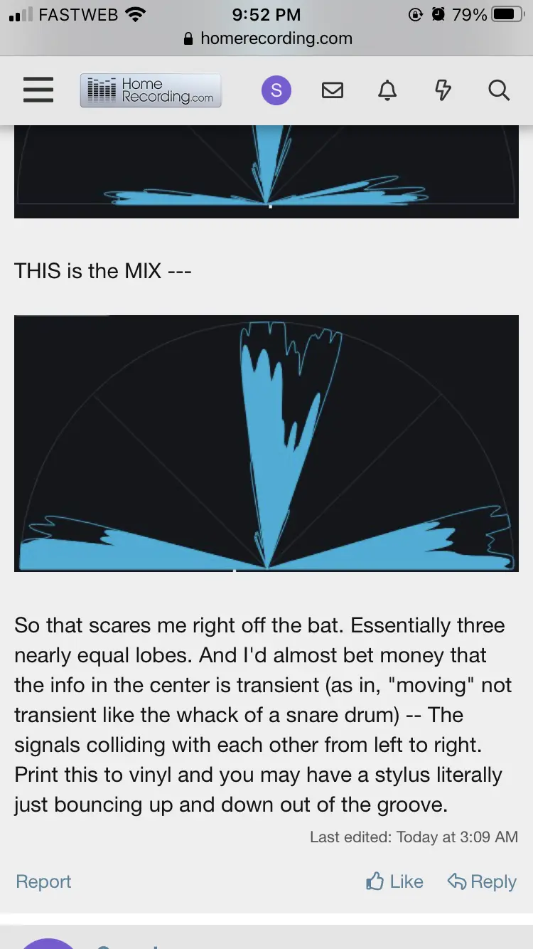

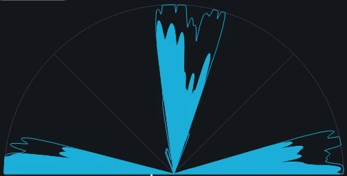

THIS is the MIX ---
So that scares me right off the bat. Essentially three nearly equal lobes. And I'd almost bet money that the info in the center is transient (as in, "moving" not transient like the whack of a snare drum) -- The signals colliding with each other from left to right. Print this to vinyl and you may have a stylus literally just bouncing up and down out of the groove.
THIS is the MIX ---
OMG, Thanks for your detailed explanation, very kind.
These are the drums, indeed doesn't seem out of phase to me, on the track there are no effects just freeG meter, also on the drums bus and masterbus there are no effects or EQ or any limiter, nothing.
I don't understand how the drum track can sound out of phase with the whole mix, and it's not just by itself. Especially when I didn't put any effect or reverb on the bus and master bus? How can it be? Maybe a bug? Some settings like latency or something like that?

Regarding the second image you posted about the mix, it's not very clear to me what should I do to fix this, signals colliding? We are speaking about a different thing here right? not about the phase issue.
Regarding the phase issue, I frankly think that if the master is excluded, and the drum truck by itself is not out of phase, then must probably be the bass which is out of phase with the drums? Because when I recorded the bass I didn't pay that much attention to the timing since it's just temporary, needs to be recorded again.
I'm saying that basically the entire mix, everything in it, is around 90 degrees out of phase with itself in relation to the other side. The sum literally sounds the same as the difference. The drums, the bass, the guitars, everything. There may be typical stereo information in there -- but if there is, it's being drowned out by the (whatever is causing the time delay from one side to the other).
The solo'd stereo drum track sounds absolutely and completely different than the drum track sitting in the mix. The track on it's own has a (surprisingly realistic for a MIDI based source) "typical" stereo spread with a typical anchor in the center. In the mix, there is NO center, there is NO anchor. Only a collision in the center during the short periods of time where a *part* of the signal exists on both sides simultaneously.

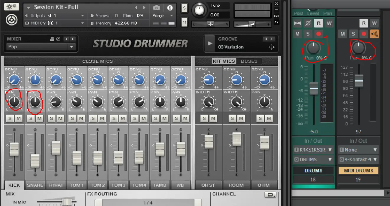

Thanks for the suggestion but Have you seen the video!? He says 2 guitars must go 100% left and right respectively.
about the drums, how can that sound too much panned if all kick, snare, cymbals are pan dead center? Drums are MIDI programmed drums! I can screenshot it for you and show you the hobs, The drums are stereo, just toms and hi hat are panned a bit L/R.
I think if you look at the OH and room Width, you will see that the knobs are full right. In the close mics, you have you panning. I wonder in your software if the panning on the close mics are fighting the Kit mics? Just looking at the close mic panning, everything looks pretty good, nothing hard L/R. Just for fun, try bring your room and OH width closer to the middle and see if that doesn't sort it out.
